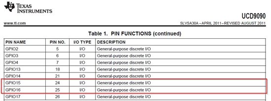

UCD9090 Datashhet Table 4 pins 24, 25
Other Parts Discussed in Thread: UCD9244, UCD9090
The specification states that pins 24, 25 are GPI1/PWM1 and GPI2/PWM2 respectively. It then states that can be used as either inputs or PWM outputs but not as GPOs. However, in the reference design for the 66AKH12 these pins are used as enables for two UCD9244 chips. The Fusion software treats them as GPIOs.
Is there an error in the specification for the UCD9090? Are these pins really GPIOs?
