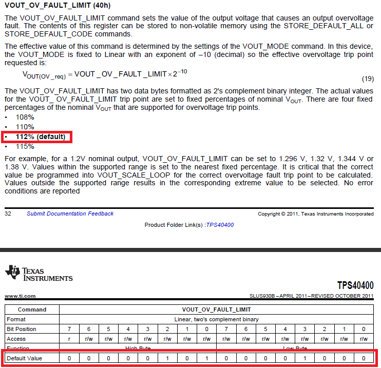

I'd like to ask about default value of VOUT_OV_FAULT_LIMIT(40h) and VOUT_UV_FAULT_LIMIT(44h) register.
In datasheet P.32, there is description that default value of VOUT_OV_FAULT_LIMIT is 112%(default) and "0000_0101_0000_1000(dec:1288)" .
I think 112% is inconsistent with this code.
The code "0000_0101_0110_0000(dec:1376)" seems to be converted to 112%.
Which is correct value of default? (112% or "0000_0101_0000_1000(dec:1288)")

    I think  the default code "0000_0101_0000_1000(dec:1288)" is calculated to 104.82%, so it seems mismached.

  • I think I have this figured out.  the value is in V x 2^-10.  So 0508H = 1288 corresponds to a trip point of 1.288 V.  It will round to the nearest percent of the 4 fixed values.  It assumes that you have properly programmed the correct output voltage and set the feedback resistors, VOUT_MODE, etc all correctly as well.  This is a really complicated device.  I suggest that you read and understand the PMBus 1.1 specification thoroughly.
    So you have to set the OV trip voltage in absolute voltage in between the four preset percentage levels.
    Let me know if you have further questions.

    Your understanding of the hex code is correct. It is the datasheet that has an error. The default setting for VOUT_OV_FAULT_LIMIT (40h) is indeed 112%, which is 0x560. The datasheet needs to be corrected.
    As for the defaults, and volatile memory, and non-volatile memory (NVM), all of the values in NVM are the power-up defaults. That is, when the device is powered-up, the device uses whatever is programmed in NVM. Once the device is running, you can change the volatile memory settings one by one by updating their values (in the TI Fusion GUI, this is done with the “Write to Hardware” button after a change in entered in the desired parameter), and those settings will take effect (with some exceptions) as soon as they are updated (again, in the TI Fusion GUI, this is done with the “Write to Hardware” button). However, those changes will be lost when input power is cycled, unless the changes are committed to NVM.
    In order to commit changes to NVM, you must issue either the STORE_DEFAULT_ALL or STORE_DEFAULT_CODE command. In the TI Fusion GUI, this is done with the “Store Config to NVM” button. Once changes are committed to NVM, they become the new power-up defaults.

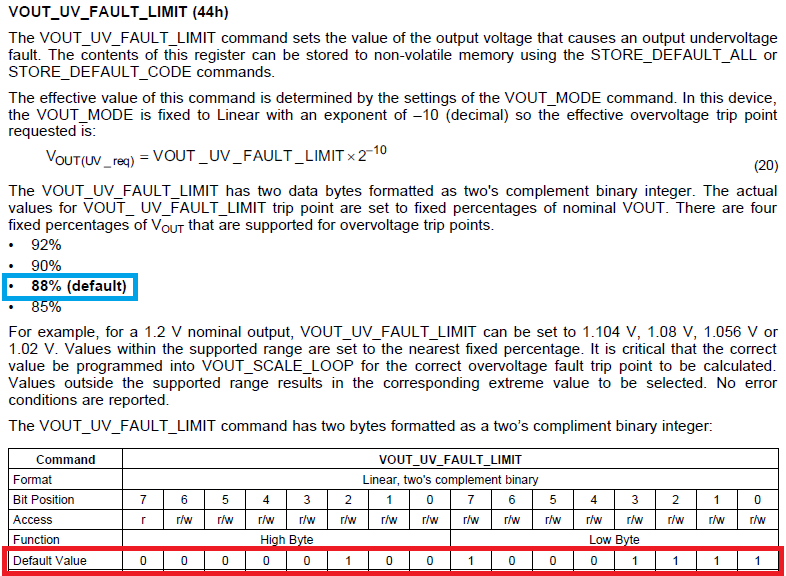

    It seems the same error about VOUT_UV_FAULT_LIMIT(44h). Blue  is correct and red isn't.
    I am glad if you verify that.
