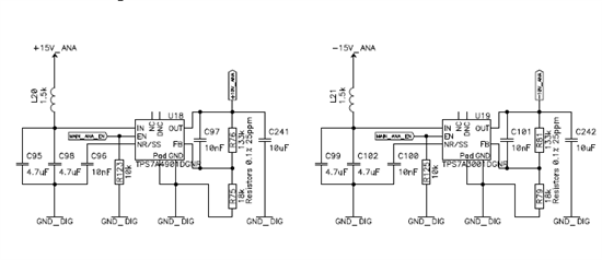

    I am sending the schematic for the moment - hope this could give a starting point for you to debug. But in general it is really strange to have a pin that you must not connect - it would most probably be some test pin but then usually it is needed to connect this test pin to some fixed potential and not to be left floating - now we have a floating pin that is kind of suspicious - could you please explain if possible what is this pin for?
    The schematic of 2 of the 5 power supplies is shown below - +10V and -10V, the rest o fthe supplies use the same schematic but with different resistor divider to have different voltatges - 1.8V, 3.3V and 5V:

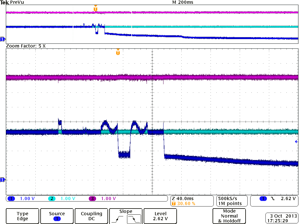

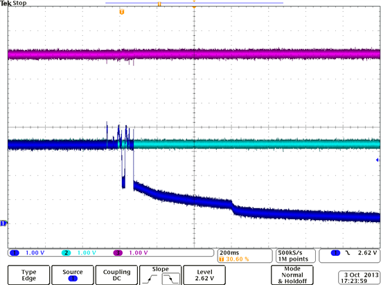

    We also succeeded to record pictures of the fault - in this case it was reproduced by one time shorting the soft start pin NR/SS to GND and removing the short. The soft start capacitor in this case was removed, the supply is 3.3V one. The pictures below show OUT (dark blue), IN (pink), Enable (light blue) - the second picture is the same event but zoomed, even after removing the short the OUT is keeping low and restores only power on/off of the board. The ripples on the OUT voltage are caused by the manual short of the NR/SS pin to GND:

    1. Shorting the output: My concern here is the amount of power going through the device here.  You could be causing an over temperature condition that is damaging the devices.
    2. Shorting NR/SS: As seen in the functional block diagram, this pin goes to the bandgap.  It is not recommended to short this pin as it is not designed to take much current.
    3. Finger probing: It is possible that you are causing an electrical connection unintentionally to another pin or voltage due to the small size of these devices.
    Do you know which of your experiments is more close to the field conditions?  I would expect the over-temperature condition to be the most likely in the field.  Have you looked at your heat sink?

    Related to shorting the output we did it for a very short time (1s) which would not lead to over temperature triggering. There is also the internal current limitation which the chip survives for unlimited time so we could not have damaged it doing this. In the field the temperature on the board was not more than 60degC and we measure with thermal camera the chip temperaure rise of 40degC maximum relative to ambient so there is enough room till the over temperature shutdown (Tj=170degC) and also the maximum opretaing temperature 125degC so this does not seem to be the reason. Related to shorting the NR/SS pin you are rightthat does not sem to be very safe manipulation but it is done also for really very short time (1s) and sometimes the chip restores back to normal operation sometimes it does not. I would expect that the internal bandgap circuit buffer will go into its maximum output current - some uAs of current, could be calculated from Fig.23 of TPS7A49xx datasheet - 1.2V*10nF/10ms=1.2uA - I would say this small amout of current could not have damaged the chip even if there is constant short on the NR/SS pin to GND - only the regulator will output zero as long as this condition is present but need to restore back to normal operation after this condition disappears.

    3. In the field is there someway for the NR/SS pin to be shorted to ground? The only thing that should be connected to this node is the noise reduction capacitor (which seems to be the case from your schematics). So I wouldn't think there is an easy way for this to be pulled low.

    3. There is no circuitry on the board that could short the NR/SS pin to GND in the field - the only component connected to the pin is the noise reduction capacitor.
