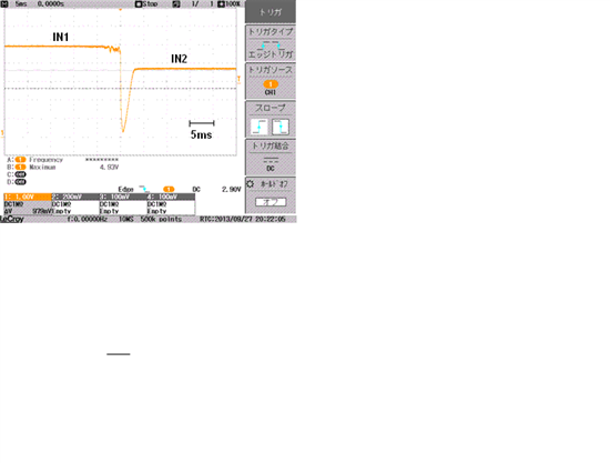

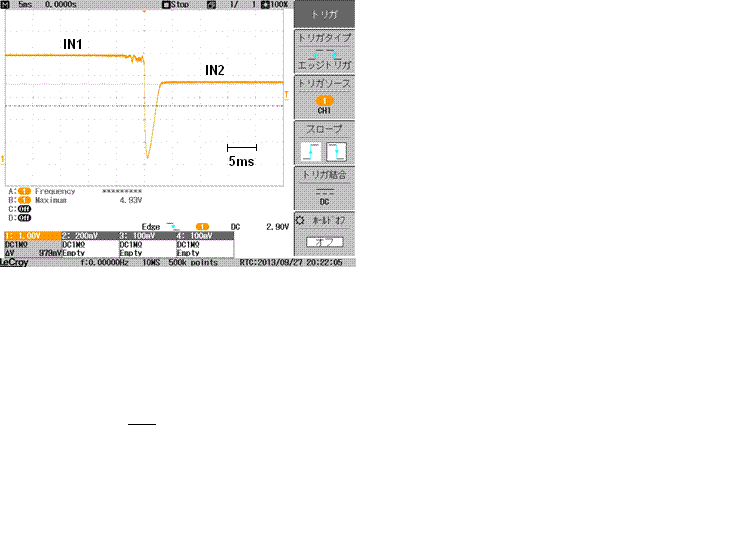

Our customer has some questions about TPS2111.
I'm posting the questions for a customer:
TPS2111 is AUTO-SWITCHING MODE (VSNS=Gnd) for testing.
D0=High,D1=Low (Output the higher voltage either of IN1 or IN2.)
IN1 =5.0V -> 0V(USB unpluged)
IN2 =3.3V
When IN1(5.0V) is unpluged(IN1=0V), the output changes to IN2(3.3V)
but the output voltage is droped before changing to IN2 voltage.
The drop period is so long(+3mS).
Output capacitor(22uF/47uF) can not fill the drop.
1)Why is the long drop generated ?
2)What should I do in order not to drop ?

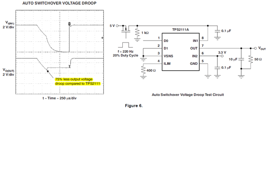

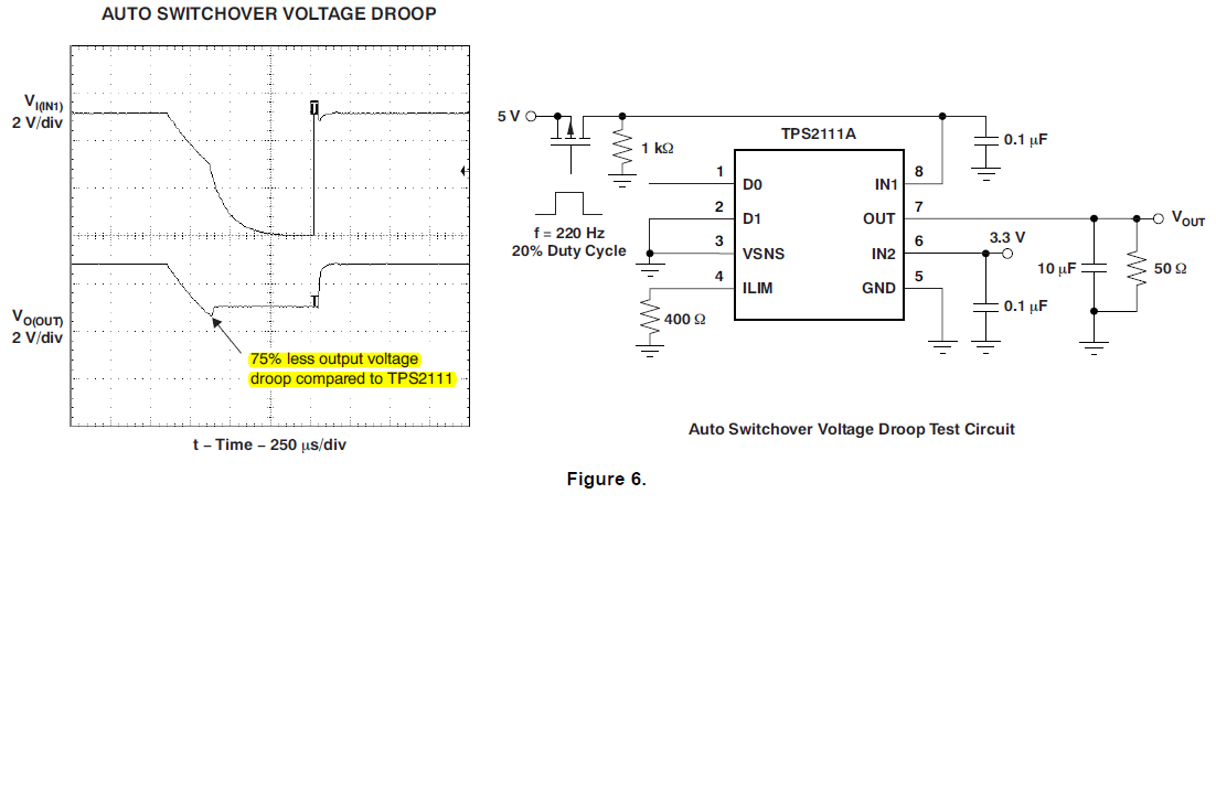

Alternatively,
I have tested the circuit of datasheet:Figure 5.(D0=Low,D1=Low/High ).
It is no drop with 22uF-output capacitor.
