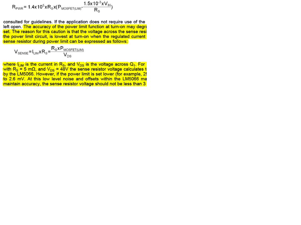

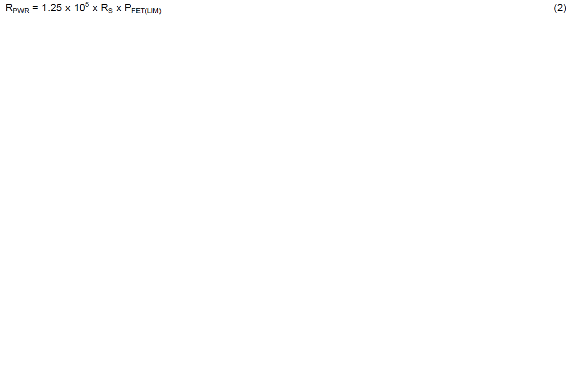

    Lastly, the LM5069 will require a minimum sense voltage (or minimum power limit for the application) for start up. The LM5069 datasheet does not mention this but you can refer to the LM5066 datasheet for an explanation (see LM5066 DS, page 22 as highlighted below).
    LM5066 DS, pg 22:
    LM5069 DS, pg 15
    LM5069 should have an additional term such as “-0.0025 x Vin/Rs” after EQ 2 to account for the offset at Vout=0V. Target start up offset voltage should be greater than 5mV (LM5066 uses 3mV in the ppg above). So, for this case it sets a minimum power limit which would then yield the minimum Rpwr for a given Rs and Vin.
