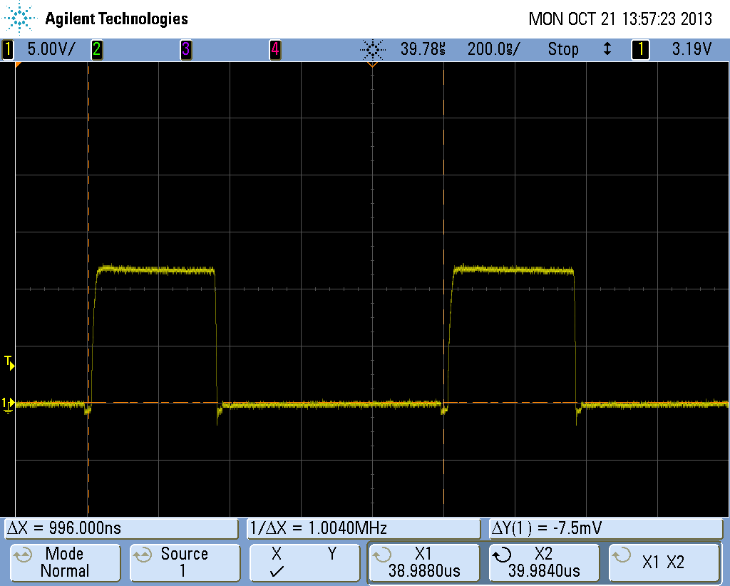

    Thanks for all of your support.  I had a chance to look at the SW node and will attach a plot below.
    The 1 MHz clock going into the TPS62110 SYNC pin has a 50% duty cycle but the signal on the SW node does not have a 50% duty cycle -- is this normal operation?  Otherwise, does this plot look okay to you?
    I still see the 16 - 17 kHz ripple on the output caps but I know part of the reason is due to the layout.  The trace that goes from the output of the inductor to the FB voltage divider resistor/cap gets too close to the SW pins.  If I remove the voltage divider PCB pad that is close to the SW pin then the 16 - 17 kHz ripple reduces but it's still there.
    Any additional comments you have would be appreciated.
    Eric Hooker
  • Yes, that looks fine.  The TPS62110 automatically sets the duty cycle to keep the output regulated where it should be.
    Yes, if the FB trace is routed near noisy sources, like the SW node, then you may pick up noise that will couple to the output.

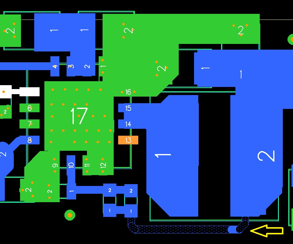

  • Do you think there is 16 kHz noise coming from the SW node?  I'm still curious about the 16 kHz noise since it causes spurs in my radio Tx.
    Does TI recommend the FB trace is buried?  My present layout is shown below.  An arrow points to the FB trace.  The small FB resistor closest to the SW node (large inductor pad with #1) was soldered on top of the part to the left of it (cap) and then its pad was cut off.  That's how I reduced 16 kHz ripple but it's still a problem.
    Thanks.
  • Yes, the FB pin/trace is too close to the SW node.  I would recommend moving the resistor and cap to pin 1 of your lower FB resistor.  Cut the FB trace off to the right of that pad.  Then, connect the resistor and cap to Vout with a wire.
    It's also possible to reduce the values of the FB resistors to make them more immune to noise.  So, if you use 100k and 10k, make them 10k and 1k for example.
  • Thanks again Chris.
    BTW, I already tried reducing the FB resistors by a factor of 10 and it made the 16 kHz ripple much worse.
