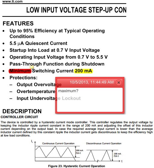

In SLVS776 TPS61222 datasheet, according to “Description” the switching current is constant 200mA, and could operate in discontinuous mode for low loads.
However in “Features” on the first page it says “Minimum” switching current 200mA.
Should it be “Maximum”? Is this a typo?
