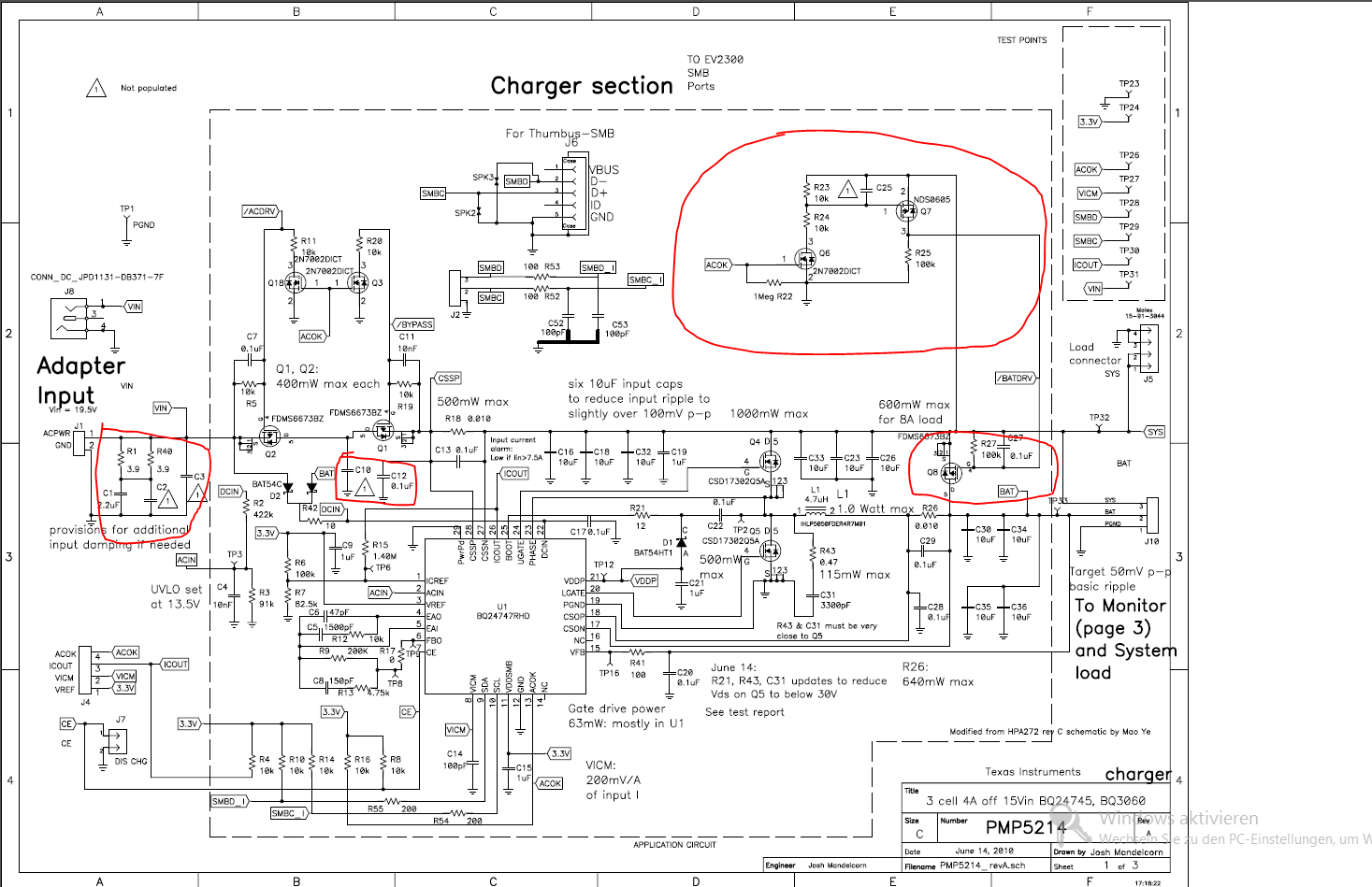

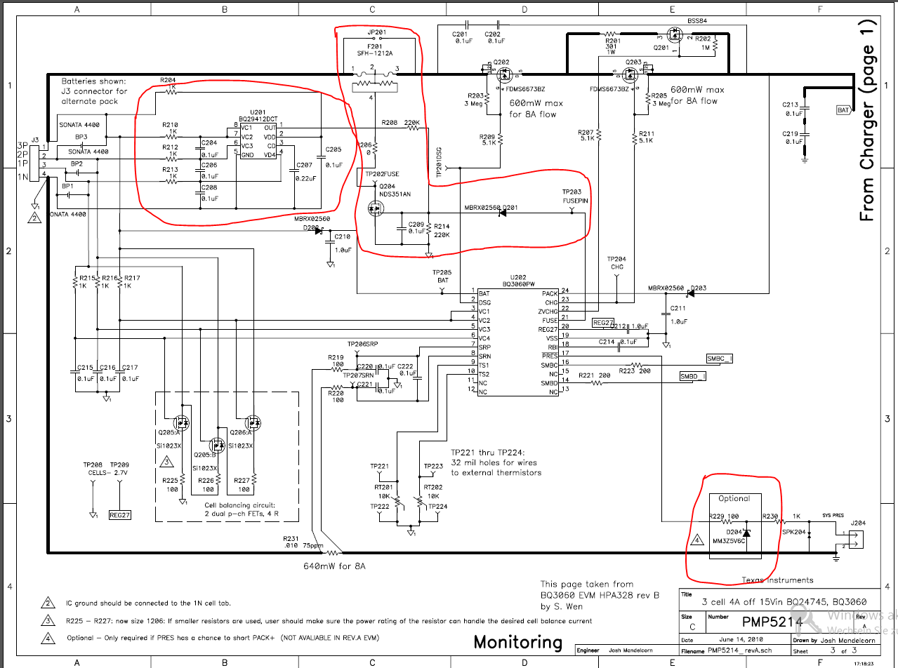

I do have a Problem with the BQ 3060 Gas Gauge. I designed almost the same circuit as on the reference design (http://www.ti.com/lit/ml/slur112/slur112.pdf) just left out the optional things (marked red in the attachment). Everything works fine so far but there is one issue that I can't solve: -->  when I remove the battery pack I can't turn on my device anymore
I did some measurements and have found out that:
when I plug in again the battery pack DSG is turned off so I can't use the battery to power my device
when I short BAT (PIN 1) and PACK (PIN 24) DSG is turn on and I can power up my device with the battery pack
also I can "activate" the BQ3060 when I start charge with the BQ24745
Have anyone an Idee ? What can I do to solve this Problem or is it maybe nassery to have voltage on BAT and PACK all the time ( what I don't thing).

My Charger IC is the BQ 24745 with the same components as in the reference design (just left out the red marked I think that are features and not needed). As Balancer IC I use BQ 3060 with the same components as in the reference design but with out the optional things like FUSE (in my schematic this pin is on ground), second safety IC BQ29412 and PRES (it's on ground).

  • It looks like you have removed the SYSPRES connection from the pack. Did you set the NR bit to 1 in the Pack Cfg B register to allow the device to ignore SYSPRES?

  • The DSG pin will disable, if the device goes into Shutdown or loses power. Are you actually removing the battery from the device?
    If the device does lose power or go into Shutdown, then you do have to apply voltage to the Pack+ pin to wake it up.

  • You will have to wake the device up, if you remove the batteries and temporarily connecting BAT to PACK+ will do this. It is not recommended to connect them together permanently, due to safety concerns. The device will not be able to turn the open the circuit as the FETs are bypassed. I have seen people place a push button switch in the circuit to allow the user to reset (wake-up) the circuit. Another option may be to connect the Pack pin on the device to the Bat side of the FETs instead of the Pack+ side. This will wake up the device when the cells are attached. This should work okay, if you are using primary cells. If you are using rechargeable cells, then the charger would not be able to wake-up the device in the event the cells were to be discharged into a shutdown condition.

  • Approximately 5.2V is required to be applied to the Pack+ pin to wake up the device from shutdown and you are correct that the quiescent current in shutdown should be less than 1uA.
    You can use the Shutdown command (0010) to force the device into shutdown, but you must apply voltage to Pack+ to exit shutdown.
    I am not sure how you would use the PRES pin to indicate that the cells are not connected. It is used to tell the device that the pack is not installed in the system, so that it can turn the FETs off for safety reasons.
