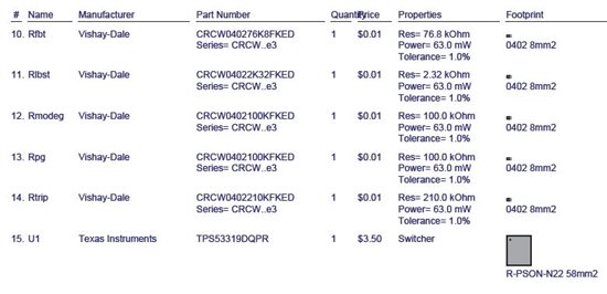

We designed a 5V,5A power section from the webench design using TPS53319. The design is

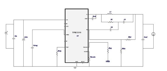

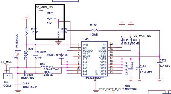

Our schematic is
We are getting a voltage drop if the load goes below 5ohm. Effectively we are only getting 1A current. Pls help us resolve the issue
