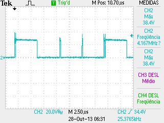

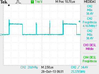

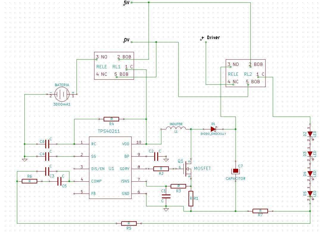

  • Hello, I'm have some problems with TPS40211.
    The parameters  that i have are:
    Vin: Battery that becomes with 6,75V and goes down stopping at 4,5V (minimun voltage of IC).
    Vout: 30V
    Iout: 250mA
    I've designed a electronic circuit board based on  schematic of figure 27 TPS's 40211 datasheet.
    I'm sending the schematic, the values of components and the waveform drain x source of MOSFET.
    R1: 0.022 ohn;
    R2: 4.7 ohn;
    R3: 1k ohn;
    R4: 320k ohn;
    R5: 56k ohn;
    R6: 82k ohn;
    R7: 1 ohn;
    C1: 1,5 nF;
    C2: 1uF;
    C3: 470pF;
    C4: 68nF;
    C5: 10pF;
    C6: 100pF;
    C7: 62uF;
    L: 0,300H;
    D: 1N5822;
     Q1: FDD2572
    Duty cycle min: 0.77;
    Duty cycle max: 0.83;
    Fábio
  • NOTE: Pin 5 is in contact with R5, R6 and C3.
