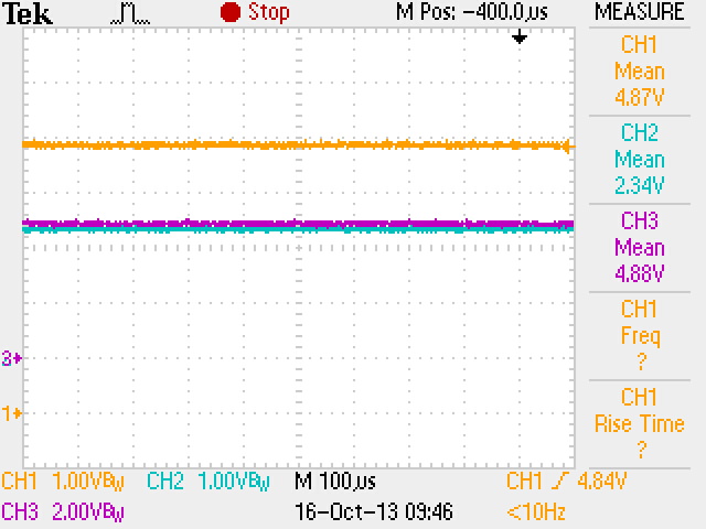

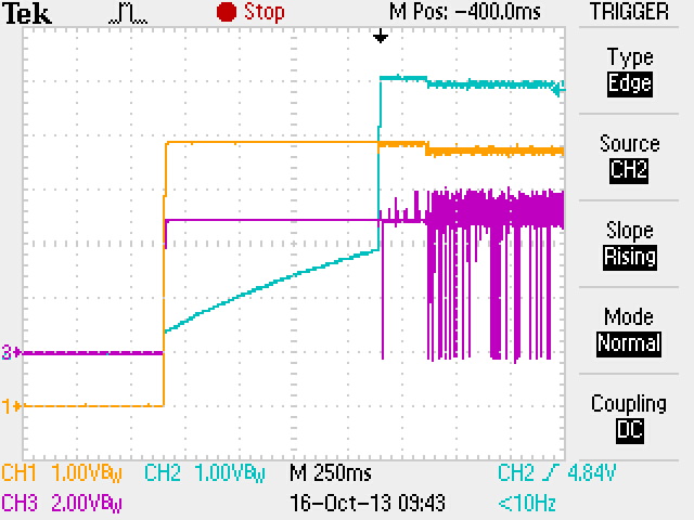

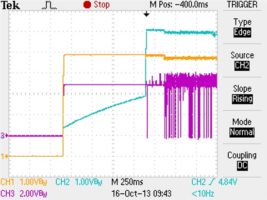

  • Normally we run from batteries (2 x alkaline in series). The unit has the option to run from a 5V mains power adaptor (after this goes through a diode the 5V is actually 4.8V). The problems occur when running from mains derived power.
    Pls see the plots below as requested:
    Yellow = Input (at pin 6), Blue = Output (caps at pin 5), Magenta = SW (pin 1)
    Outputting too low:
    Decreasing Vin slightly and device starts switching:
    Switching from start-up:
  • Thanks for the waveforms.  Since your third waveform shows a proper startup, I'm confused as to how you get the first waveform?  What is different in these test conditions?  Also, what is your load for each waveform?

  • Thanks Chris. There's nothing different in these test conditions other than the slightly differing Vin. The load is the same ~15mA, then it switches to ~100mA after a delay of around 300ms (you can see this as a slight Vout drop in the last waveform). The load is simply 5 LEDs in parallel.
    I had concluded the same (adding a diode or one with a greater Vf) as a work around. I also have some TPS61220s on order as well.
