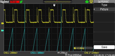

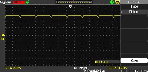

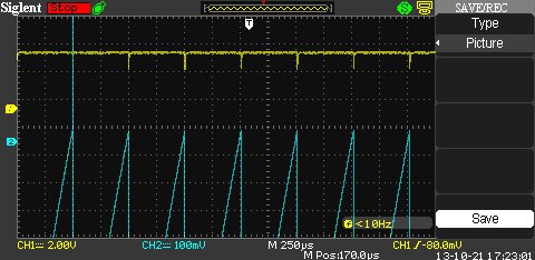

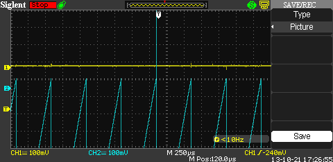

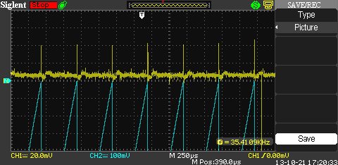

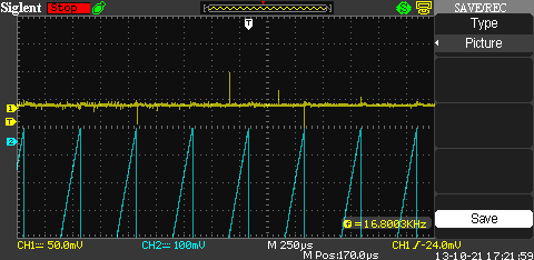

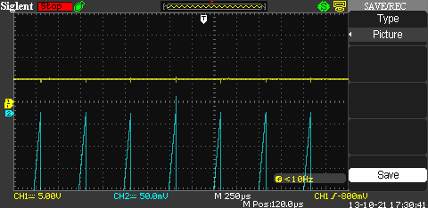

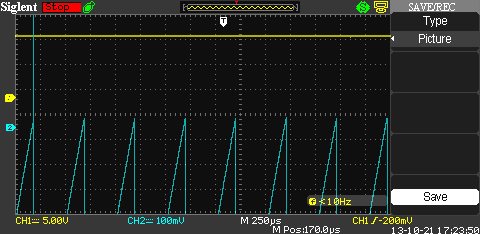

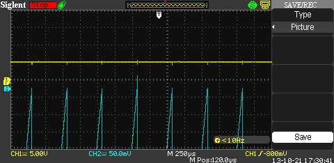

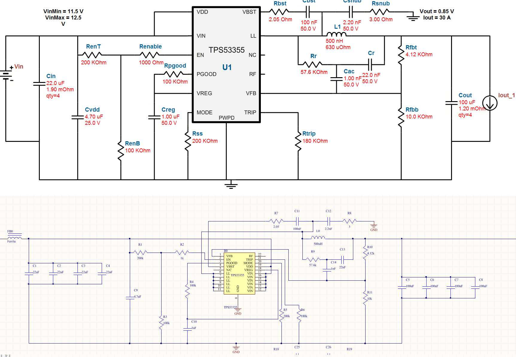

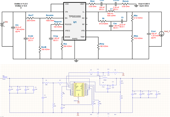

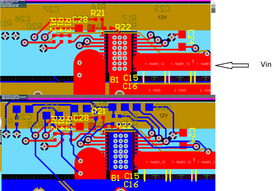

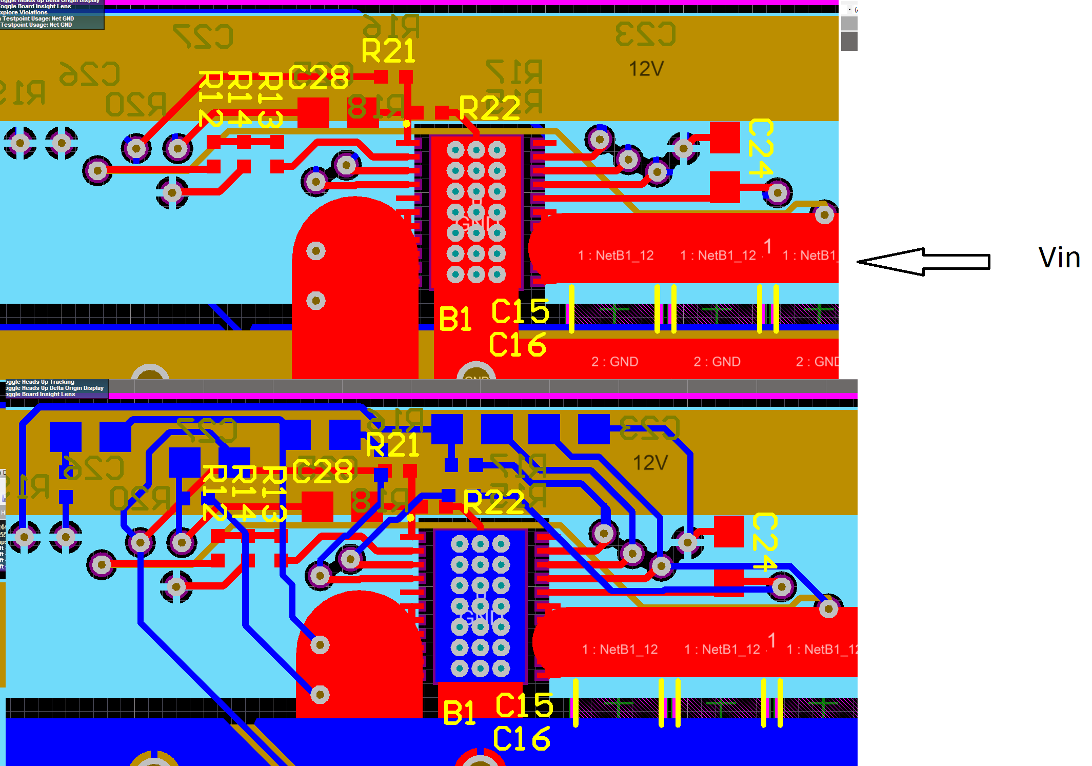

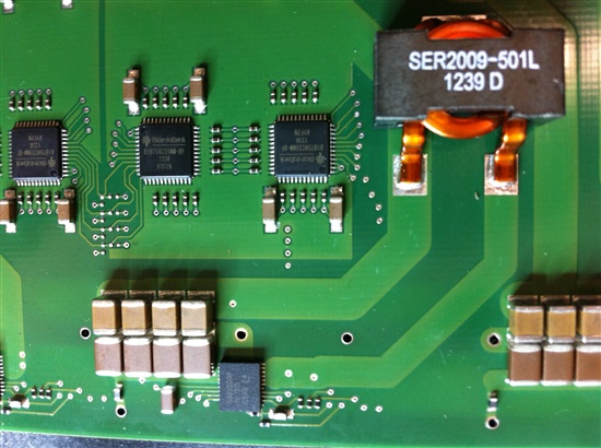

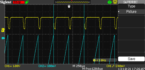

My design requires an 30A @ 0.65V output.
I follow the istructions in webench and the instructions for layout in datasheet.
The components are the same that webench software advice.

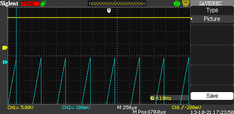

When i light up the circuit there is no output voltage, in the LL pin i can see the controller switching but at the output of the inductor i have 0V.
PGOOD 0V, VBST 5V, EN 4.2V, VREG 5V.
Maybe the iductor is too far from IC?there are 25cm of distance.
I know thats difficult to reply this demand but, anyone can tall me what are tipical errors using this chip?
The schematic is ok, I m sure! connections in layout are ok.
I think the problem is at start, circuit cannot reach the 0.65 V , VFB 0V consequently PGOOD 0V.
Farther after 15 seconds everything shut down(I can no longer see the ic switching in LL node).
