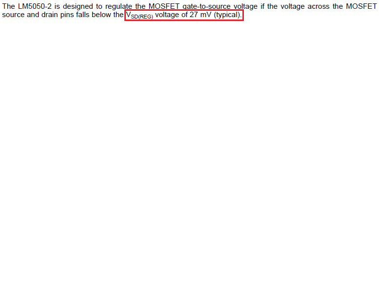

I want to ask 2 questions about the LM5050-2.
Could you follow me please?
(1) In datasheet P.11, there is description below. It seems VSD(reg) is 27mV(typ).
But in electrical characteristics, VSD(reg) isn't specified 27mV(typ). Is 27mV(typ) typo?
(2) In electrical characteristics, VSD(reg) is specified under VIN=6.0V and 12V.
My customer wants to know the value VSD(reg) under VIN=40 and 60V.
Do you have the VSD(reg) data under this condition?
