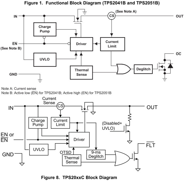

For 0.5A USB current limit protection, TPS2041C and TPS2041B seems the same in many aspects. Could someone point out their difference?
For example,
Martin Pakota pointed that TPS2041B lacks the OUTPUT DISCHARGE that TPS2041C has.
he also mentioned that TPS2041C thermal data can be used for TPS2041B.
However the datasheets doesn't make clear the difference between the two. Could someone clarify it?
