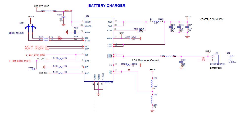

    We have used this battery charger in one more product. Attached is the sch. Sometimes we get proper VBATT = 3.6V and sometimes, VBATT goes to 2.9V which would make PMIC (which is powered from VBATT) failed to produce some of the voltages. Any specific reason why it has to go 2.9V from range is from 3.5 v onwards.
    INitially battery is not connected to the charger. Would it cause any serious issues.??
    YKFS
  • It looks like you have PSEL high, which implies USBinput, and not sure what OTG is biased to LOW (100mA) or HIGH (500mA).
    If your system load is too high you may be stuck in IDPM mode.  Check your input current versus your setting.
    What is your ILIM pin set to?  This could also limit the input current.  See data sheet for more details.
    The converter has short circuit mode if the system is below 2.2V and then the converter only delivers 100mA, but this does not seem to be your case.

    I have one more issues. When we plug in USB charger and read battery charging registers, it shows Battery discharging means battery is not getting charged. However, it detects power input to the battery charger.
    Any discrepancies in the attached sch please let us know.

    We checked below things. Power good is Low. BAT FET is ON by reading register values. But one things observed, TS pin voltage were close to 3.7v and  when we changed R123 and R124 to 10K ( which was forming divider with approx 2v for TS pins, battery started charging. But with TS status as "overheat". There is no TS output for our battery. We have external Fuel gauge to sense battery parameters.
    How get rid of this overheat while reading the battery charger registers. What could be the TS levels to be set.

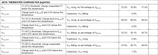

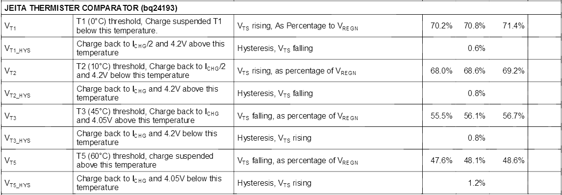

  • If the TS feature is unused, the pin should be biased at ~50% of REGN voltage.  From the datasheet you are correct to use two 10k resistors:
    Please measure REGN Voltage (should be 6V) and your TS pin voltage. The datasheet also provides the reference thresholds for TS pin functions:
    Please let me know if this helps or if you have any further questions!
