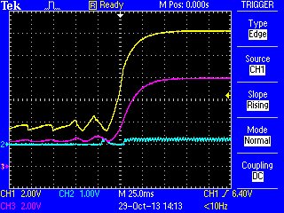

I am having a brown-out recovery problem with the TPS54525 on the evaluation board (originally brought to my attention from prototype units, but duplicated the problem on the TPS54525 evaluation board).
The evaluation board has been altered to increase the output voltage to 5V (R1 -->124k, R2 -->22.1k).  VIN=12VDC (bench supply), Vout=5V, load is a 250R power resistor.

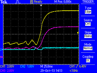

When VIN is ramped down to ~3.5V, then ramped back to 12VDC, the output stays low (pulsing, ~230mVRMS).  Has anyone else had this issue, or have any insights on this?
Scope captures: CH1 VIN, CH2 Vout, CH3 varies [EDIT: these captures are from the prototype board, not eh Eval board]
   Cold start (from everything off), CH3 Enable

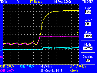

    Return from brownout, CH3 Enable

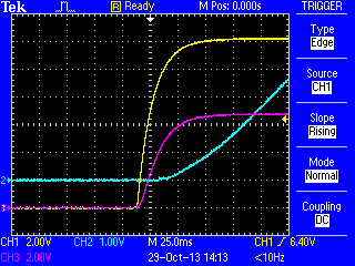

    Return from brownout, CH3 Soft-start

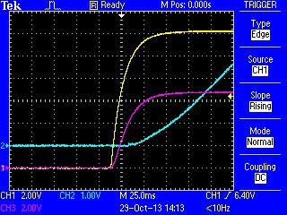

    Return from brownout, CH3 VREG5

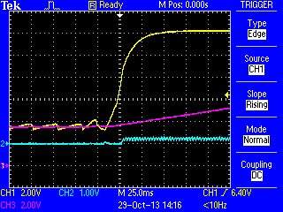

  • Further reading and investigation within similar products (e.g. similar issue with TPS54526 reported) indicates that this may be an expected behavior: when a brownout occurs, a voltage sag at the output triggers UVP.  The UVP is a latching state.  Unfortunately, nothing else reaches a low enough voltage to restart the TPS54525 once an acceptable voltage returns: if I manually disable then enable using the jumper on the Eval board, the system is restored.
    Do you agree/disagree with this analysis?  Thoughts on a way to address this behavior?

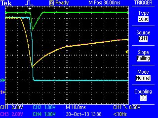

    [EDIT: Capture from the Eval board]
     CH1 VIN, CH2 Vout, CH3 En, CH4 SS
