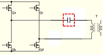

I'm sorry to ask about basic question.
I think coupling capacitor in series to transformer is necessary to prevent uneven magnetism in normal full bridge configuration.
Is this capacitor unnecessary in phase shift full bridge configuration(UCC28950)?
Yaita
  • You do not need a capacitor with a phase shifted full bridge controller such as the UCC28950.
    This is because the UCC28950 has an input monitoring the primary side current in the bridge. If the current looks to be unbalanced, then the controller will make adjustments to bring the current back into balance.

  • Hello Kensuke-San
    In answer to your original question.
    If the UCC28950 is operating in Current Mode control then a capacitor is not necessary. If it is operated in Voltage Mode control then a capacitor is necessary. This distinction applies to all devices controlling a full bridge power stage, not just the UCC28950.

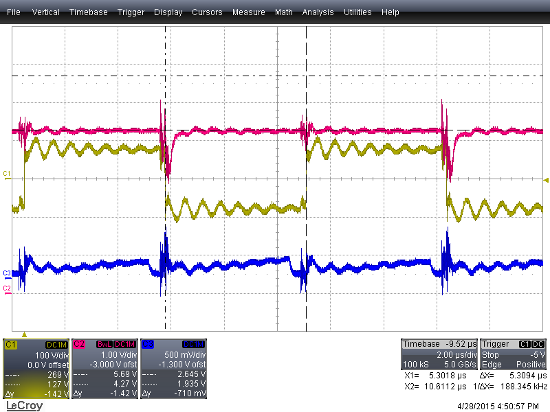

    You may try this: Take the Evaluation Module, supply it with a low voltage, for example 200 V DC so the EA saturates as the 12 V output cannot be reached. Connect a low load and see (or imagine) what happens.
    I mean that I agree that the capacitor is not needed in NORMAL operation, but if for some reason the EA saturates, it seems to be necessary.
  • Hello Francesc
    I took a UCC28950 EVM - ran it at 200Vin and 200mA load, Vout was about 8V at this point. I also tried it from 0Vin up to about 300V. There is no evidence of transformer saturation.
    Yel:  Transformer primary, pin 1 to pin 5
    Red: COMP pin on controller
    Blu: Primary current sense signal
    Vin = 200Vdc, Iout approx. 200mA
    EA has saturated, COMP is > 4V and the system is locked at max duty cycle –
    There is a small imbalance in the bridge on times - about 40ns. This can be seen in the peak current amplitude too.
    Ton:
    5.31 us on –ve part of waveform
    5.27 us on +ve part of waveform
    Colin
  • Thank you for doing the test.
    40 ns over 10 us means 0,8 V over 200V.
    In the EVM the MOSFETs Ron is 0,22 ohm and the primary resistance 0,215 ohm. So I estimate a DC current of 1,2 A.
    I do not know the transformer characteristics so I am not able to calculate if this will saturate the transformer. It would not saturate the transformer I am using in my latest design (which supplies more than twice the power of the EVM), and probably does not saturate the transformer of the EVM.
    But in my case, Ron is 90 mohm, primary resistance is 28 mohm and I would get 3,8 A and 1,2 Teslas, so complete saturation.
    I suppose my calculations are right.

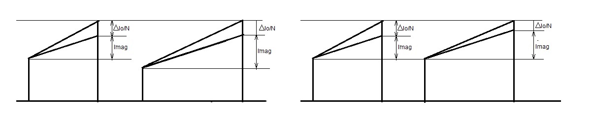

  • Thiking again on what Ali said, I have to agree partially with him, that in certain cases the peak current control does not prevent DC unbalance in the transformer.
    If there are different delays in the gate drives, or different Ron in the MOSFETs, this is not a problem, it will be corrected by the peak current control.
    But as the peak current control measures the total primary current, but not the magnetizing current,  I can think of at least two cases where a problem may exist.
    In the enclosed diagram,  the first drawing is a very improbable case of a split secondary which is not well balanced. The current reflected to the primary is different in each half cycle. The slope of the magnetizing current is always the same, V/Lp, so the peak limit is reached at different times and the magentizinbg current is not the same.
    The second diagram corresponds to a current doubler, where the two inductors have not the same value. Because the ripple current in each inductor will be different, the reflected inductor currents in the primary will be also different in each half cycle, and as seen in the figure, the magnetizing current is unbalanced.
    The drawings are exaggerated, but I think one has to calculate the unbalance of the magnetizinc current taking into acount the worst cases. Normally the DC current caused by the problems I have explained should be ver low and in the worst case just a small air gap will solve the problem, as Ali said. But the worst case is when the error amplifier saturates and then I think that the best solution is a capacitor in series.
