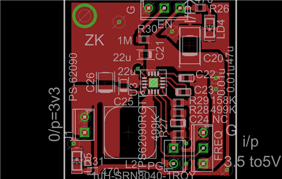

 We are using TPS62090 regulator(chosen by using web-bench) for our device(which consumes approximately 1A,input voltage for regulator is 5V dc). Initially all the things are working fine, but after few days (sometimes it will be in hours) the regulator will gets spoiled/ will give troble. Means the Vout(SW) and GND pin gets shorted and we getting 0V in SW pin. We replaced regulator so many times but we getting same issue.
Please check the layout diagram and provide your best advice to solve this problem.

  • Hello Naveen,
    Please provide the screen shots of the layout larger/higher resolution with the top and bottom layers isolated so that I can see them both clearly. On the order of two to three times larger would be nice.
    Also provide a screen shot of your schematic so I can follow through the nets to the layout.
    What is your soldering process? Do you clean the solder flux off of the border between the soldering and testing? This flux can have a habit of re flowing and providing conduction paths that can reek havoc on your system.
    Ryan May
  • Hello Ryan May,
    Thanks for your support. Please find image contains all view of layout and schematic.
    We are using manual soldering by hand using hot blower(smd rework station).We will clean the flux using isopropyl alcohol with a brush. This is for our prototype. All the things are working fine except power supply part. Please advice to solve the power supply issue. So that we can go for production stage. Our device consumes ~1A to 1.2A at 3.3V using 3.7V Li-Polymer battery.

  • It is clear that this layout does not follow the example one in the D/S (used on the EVM) very well.  Specifically, the SW node should not be routed through vias, the grounds should be tied together, not separated by an inductor, and the input cap should route very direct to the IC's pins.
    I recommend ordering the EVM and testing that known good design.  Then, copy the EVM design onto your PCB.

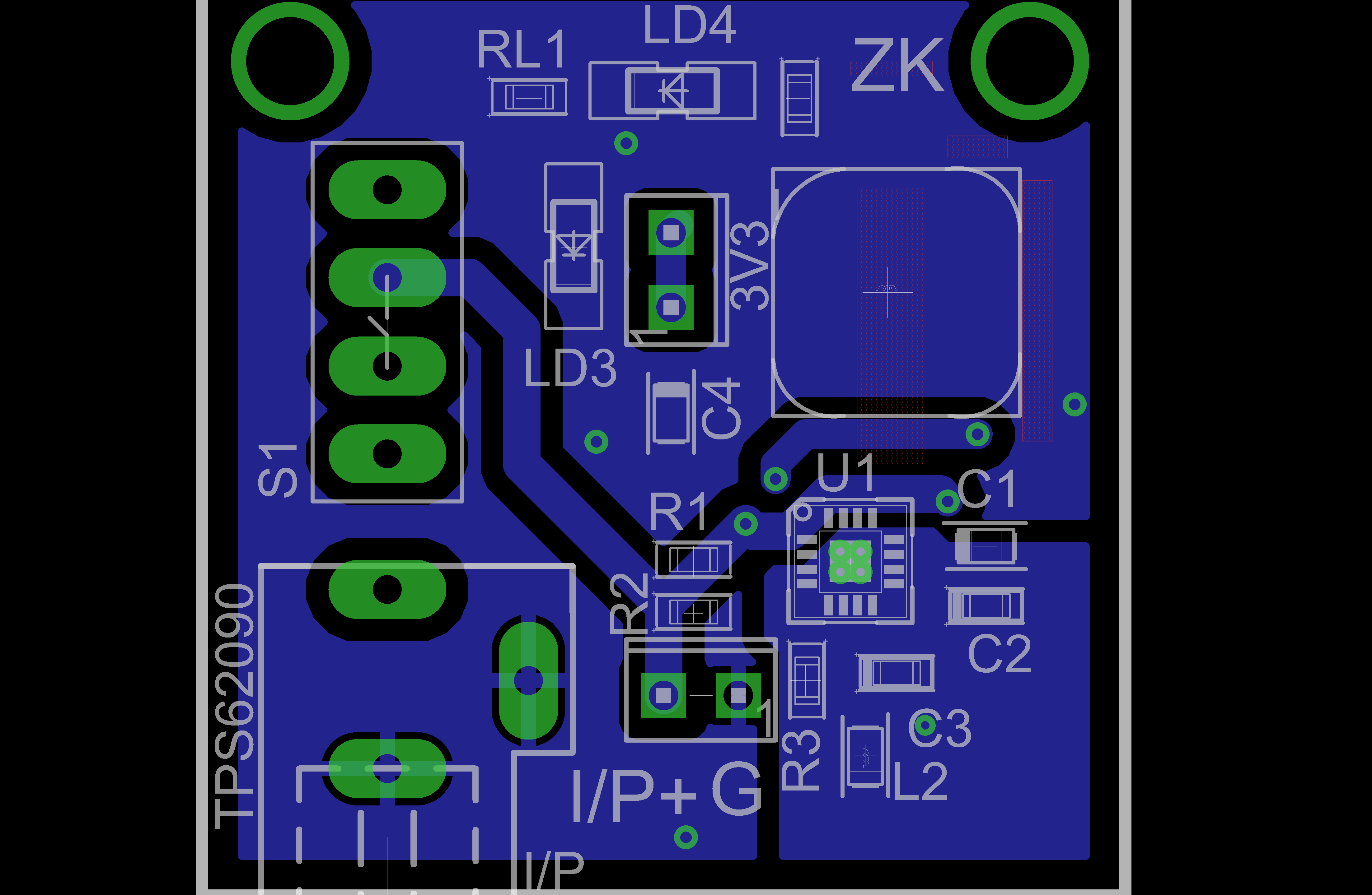

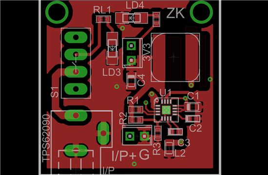

    We are facing  problems regarding to TPS62090 converter.We had spoiled so many regulators(GNDand o/p pin gets shorted) which has posted in the previous post "http://e2e.ti.com/support/power_management/non-isolated_dcdc/f/196/p/300653/1054219.aspx#1054219" . I have referred TI evaluation layout design for our new design which is shown below. So please check and verify the design and suggest me. Pls Let me know any changes required for our new design. So that we can give it for PCB manufacturer.
    Naveen K
  • Yes, this layout looks much better.
    I noticed that on your EN and FREQ jumpers, two of the pins are shorted.  This is likely not desired.
    A final improvement to the layout would be routing the grounds of C22 and R29 (that whole GND island) back to the AGND pin directly and not using a via into the GND plane.

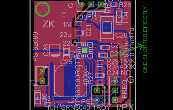

    Regarding to ground of C22 and R29, in EVM design they shorted AGND(pin 6 and tab) and PGND(14 and 15) then connected to other ground pins using via. I have modified the design as per your advice pls check and advice which one is better. We thought, if we do like this we will mix the AGND and PGND and if we consider other things its difficult to connect C22 GND to PGND without using via  . So this is my confusion please clarify this.

    I think either of your layouts are ok.
