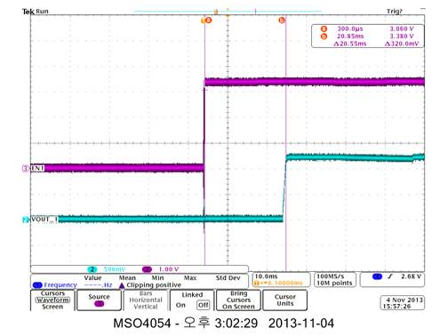

Enable time of TPS65251
Other Parts Discussed in Thread: TPS65251
Our customer will use TPS65251 Device.
Our customer has below question.
If see datasheet, TPS65251 device has SS(Soft start) function.
Purple : Enable Signal / Green : Buck 1 Output
Our customer did use 4.7nF in SS Pin.
Why happen 20.5msdelay between Enable and output?
Our customer did remove 4.7nF in connected SS pin, But Test result is same...
