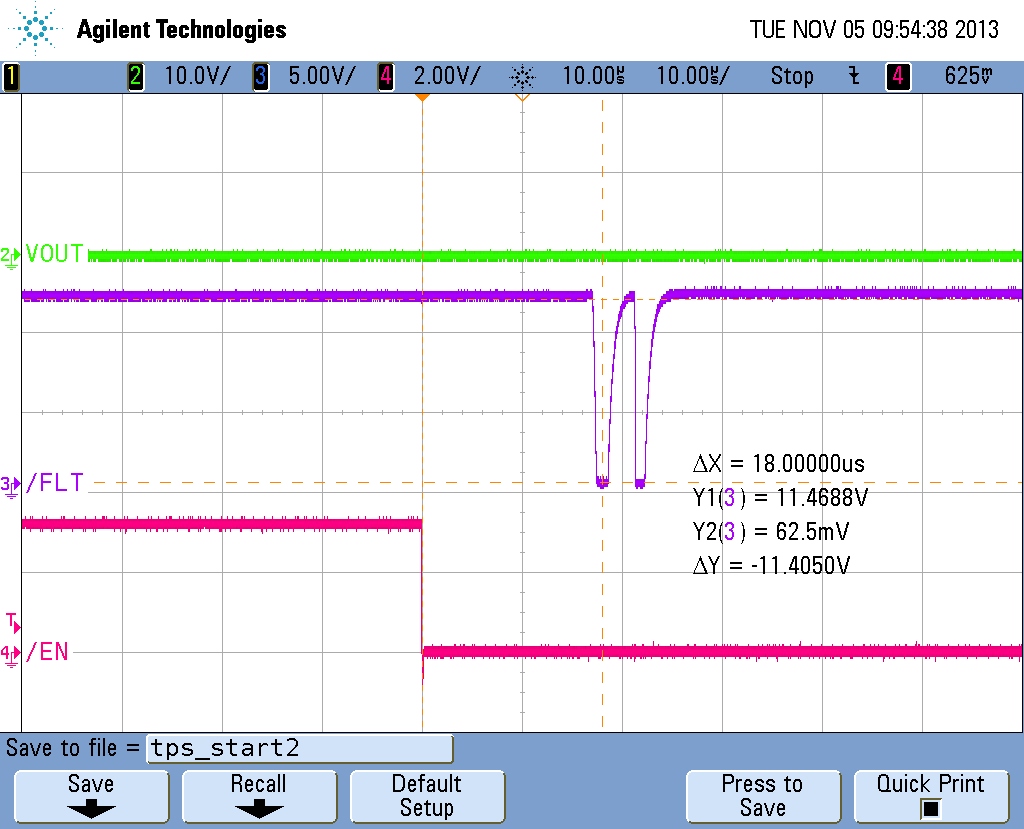

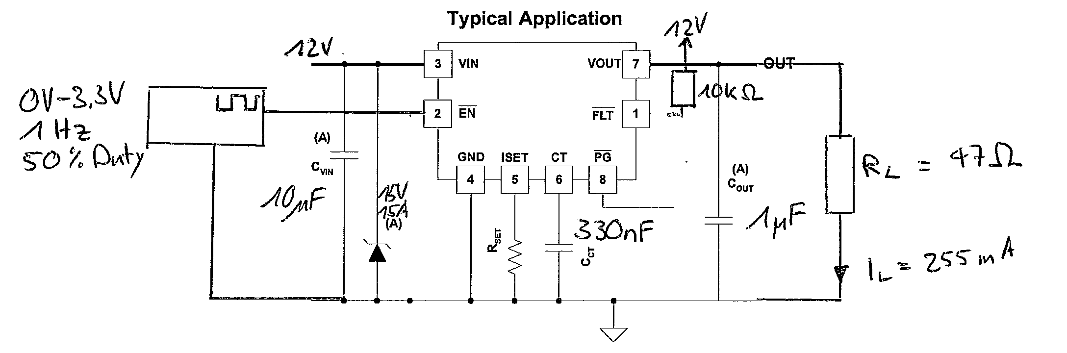

I have a question about the TPS2421-2 startup reaction on the Fault signal (/FLT).
Whenever I set the enable Pin low (/EN) the component starts to switch on the output.  But as you can see the /FLT is triggered (low).
My questions:
-          Is this a normal behavior or just a circuit problem?
-          Do you know why /FLT goes low?
Below I attached the schematic and the measurement results.
 - Schematic:

Startup 1:
You can see the enable (/EN) goes low, the component starts drive the output.

Startup 2:
Same measurement as above.
As you can see, also on shutdown the /FLT signal goes low.
