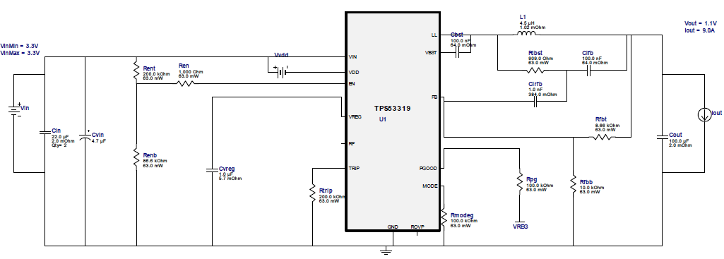

 Customer designed a Vin=3.3V,Vout=1.1,Iout=9A power section from the webench design using TPS53319.
 The design is
Customer  can not use the electrolytic capacitor in Cvin because of the height restrictions.

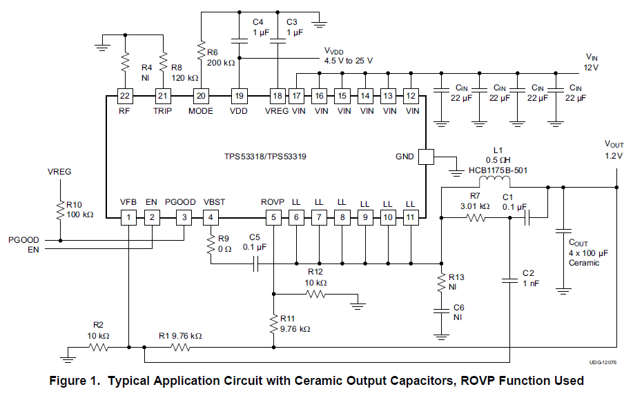

There was no description about the selection of the input capacitor to the data sheet.
Can I substitute a film capacitor or ceramic capacitor to Cvin?
