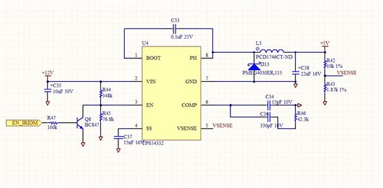

I have designed and fabricated an application powered by TSP54332.
Conditions are: Ip: 10-20V
Op: 5V
I: 2.5A
After the assembled PCB came back from my Chinese manufacturer, I found that the chip they have assembled did not work in my circuit. When I changed the IC, the circuit worked.
The chip that did not work has following markings on the SMD package:
54332
TI 07H
ZJ02 G4
I've attached my circuit for your reference:
