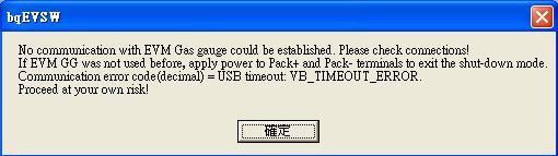

following is the EV2300  connect to  the EVSW   Error

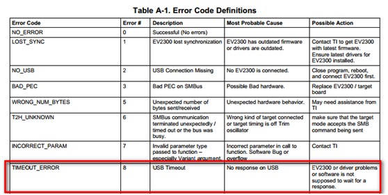

I  find some  error  code
