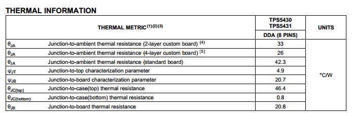

What is meant by "standard board" within the attached table from the datasheet? (third from top)
JEDEC standard high -K coupon. See SPRA953 for details:
http://www.ti.com/lit/an/spra953b/spra953b.pdf
