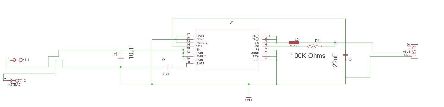

I am using TPS62143, I just want to know, if I connect SW1 SW2 and SW3 together!! Or must I seperate them "I connect Vin only on SW1"?!!
Please help me!!
Here my schematic!!

Pins 1, 2 and 3 are the same signal SW. You should connect all 3 together as you show in your schematic
Thank you John for your quick response!
So, is my schematic good?! I want to put 12V, and get 5V/2A?
Your schematic is a good copy of figure 43 in the D/S.

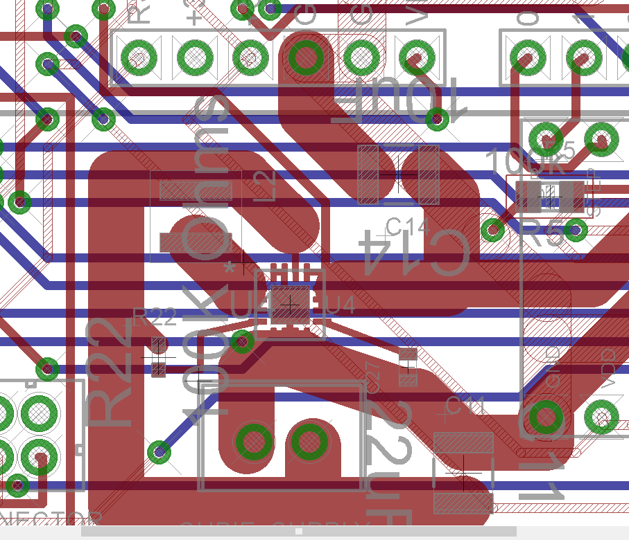

In a typical design TPS62143 is dissipating its internally generated heat through the power pad on the bottom. This perfectly works if the device is assembled on a PCB with a suitable layout. A heatsink would not be required then. I did not find layout information in this post so I can not check that.
If I read your comments right in your setup the TPS62143 does not work after removing USB power. There is no output voltage and it gets hot. Did it ever work before connecting USB?

The device has a thermal shutdown. If it gets too hot it turns off itself. It would recover automatically after cooling down. But all this only works reliably if the device is properly soldered on a PCB.
If the device is not recovering it has been damaged by anything you did during your experiment. To dig into that deeper I need more information. A good start would be reviewing the PCB layout.
Thanks. Although this layout does not match to the schematic you have posted above, it helps. I am afraid this layout needs some rework. For example the input loop for connecting the input capacitor to the device is very wide. It is the most critical part of the circuit and needs to be as tight as possible. The output loop is wide as well. I also do not see thermal vias in the power pad. They would be required to transfer the heat from the device into the PCB.
You can find guidance for reworking your design in the device datasheet (capacitor selection page 19, 20; thermal design page 23; and layout page 22, 23) or in the EVM documentation.
