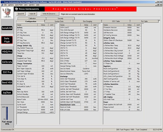

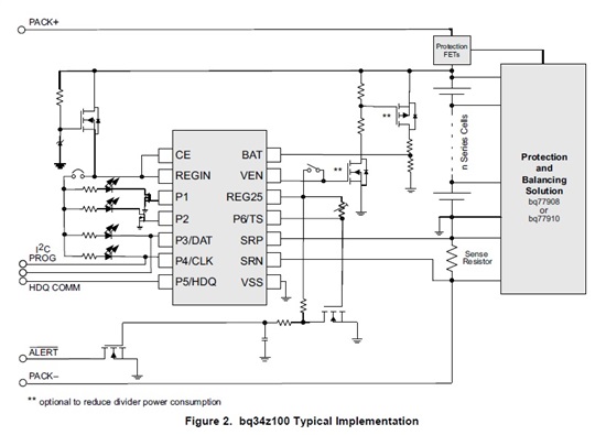

I am configuring the BQ34Z100 to 2-in series cell ( LiFePo4 ) and is intending to use 4 LED and a tact switch. The schematics .
I managed to link the fuel gauge to my EV2300 . And also able to get the reading on screen.
2 questions :

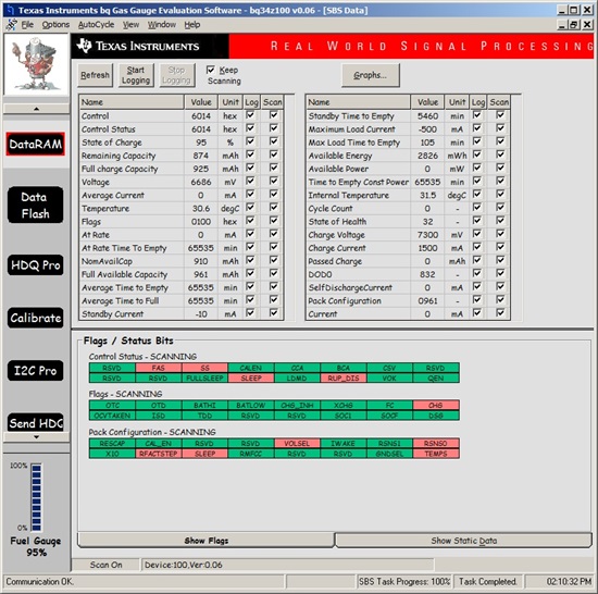

1) I cannot get the Full charge capacity reading to stay at 3000mAh. I send B80B Hex to command 0x00 and the Full charge capacity changed to 3000 mAh, but after I depress the tact switch, the reading goes to 925mAh... why is this do ?
2) I cannot get the P3 and P4 to turn ON the 3rd and 4th LED. I can only get P1 and P2 signalling the 1st and 2nd LED. Even when the capacity is above 50% ~ 100%, the 3rd and 4th LED just did not light up... what configuration is wrong here ?
  • I have tried to play with the content at LED_COMM CONFIGURATION, but no matter what configuration I choose, the 3rd and 4th LED just did not light up.. why ?
  • I attach the configuration window here as well...
    thanks
  • Are you using the I2C interface for communications? You have to use the HDQ interface when using the 4-LED option. Using the I2C interface will prevent the P3 and P4 from driving the LEDs.
  • hi Thomas, you are absolutely correct !
    All the 4 LEDs is lighting up perfectly now. I click on the "sent HDQ", and then perform a "change comm to HDQ" to the fuel gauge ( irreversible process ), reset the entire system and the lights are lighting up perfectly now.
    beautiful...
    thanks, problem solved.

  • Solomon,
    You can update parameters with bq34z100 HDQ bqEVSW program and it will allow you to import and export senc files to save configuration into other devices. This will be extremely slow. We recommend using the I2C interface for programming the device and then switch it over to HDQ mode after programming has been completed.
    Tom
