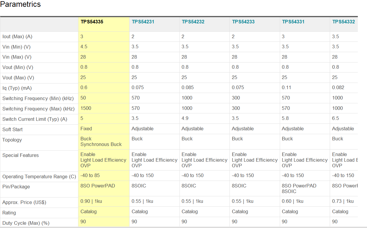

How to Understand the Maximum Duty Cycle TPS54335 ?
I found on the table TPS54335/6 was defined as 90% as the maximum duty cycle.
How to understand it?  Does it support all corner condition for 3A operating?
Can I caculate the Vout/VIN less than 90%?
Or this 90% is only ensured on EVM about the SW waveform, and for minimum VIN for given Vout should be higher than 1.1 times that of Vout?
