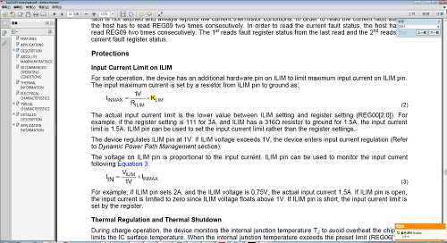

I am studying the charger IC bq24295 spec and having operation on its EVM.
However, I found that there is no introduction about the parameter " KLIM".
(Please see the highlight place in the picture below)
Please kindly help us. Thank you very much.
