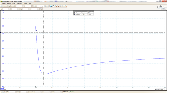

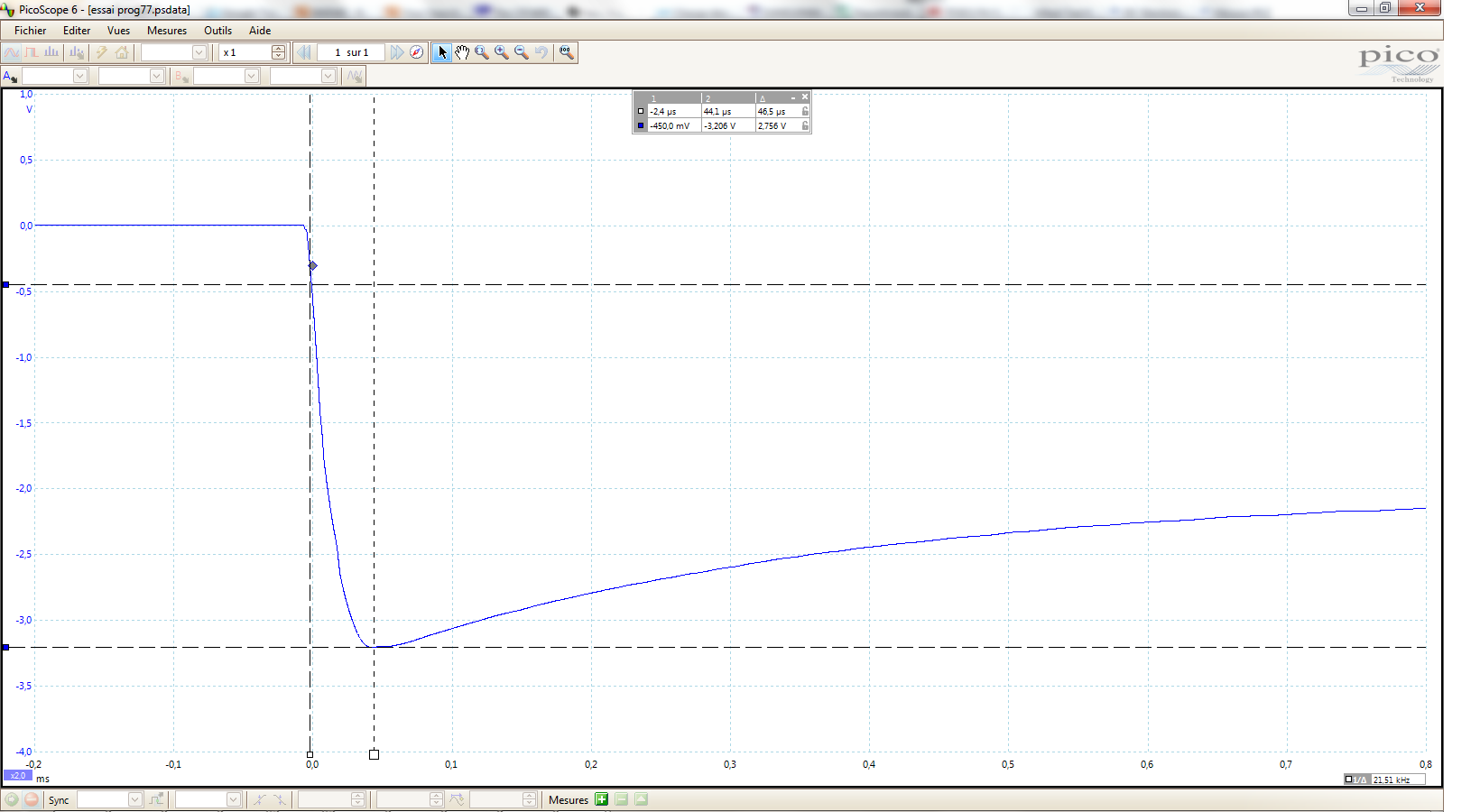

My problem is the short circuit, because I have try different values in the AFE SC Dsg Cfg register and I don't have different values with an oscilloscope.
For example:
with 0x77 programmed in AFE SC Dsg, of -450mV at the end of the shoet circuit, I have approximatively 50µs on oscillogram whereas, if I understand, I should have 427µs.
I don't understand why.
