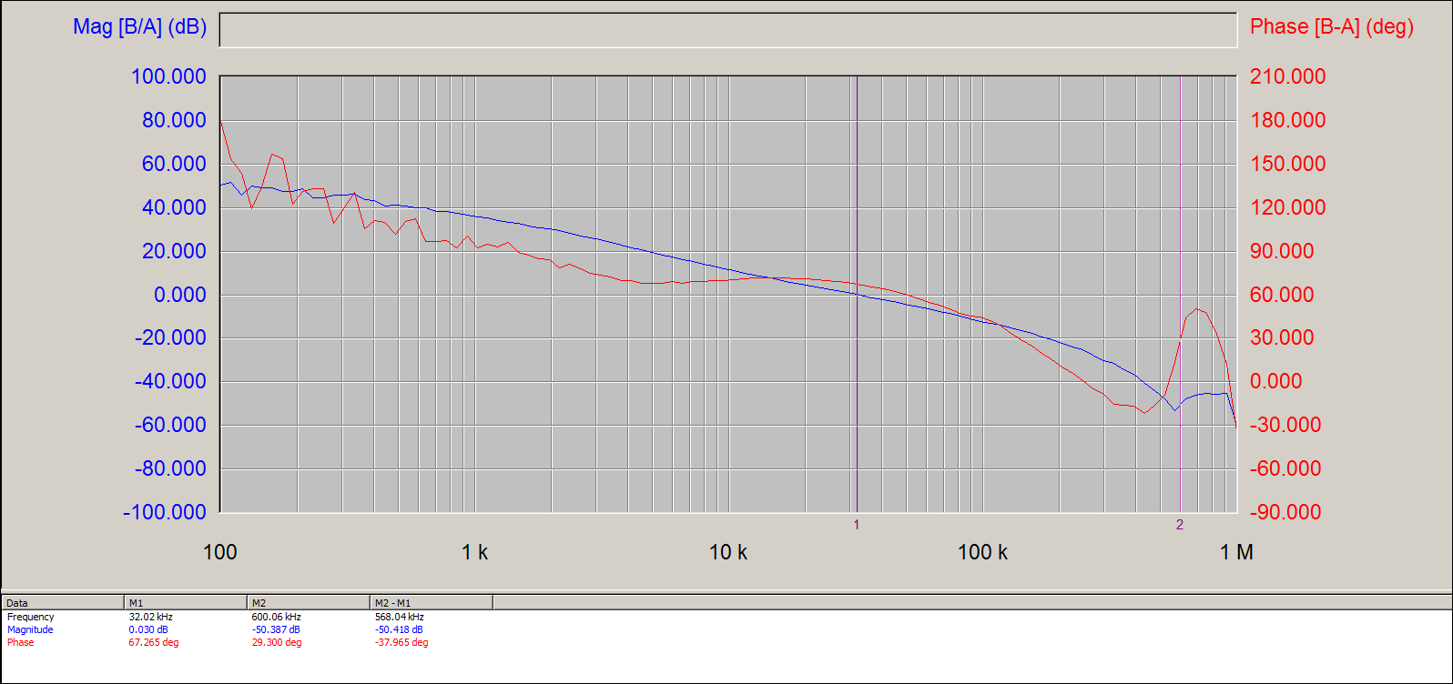

  • It's been a couple years since I have worked with TPS54218.  I would have to look at the power stage gain and phase characteristics to see what is going on with the two models.  If you have a TPS54218 EVM, you could always measure the loop to see if it agrees.  I doubt that I have an EVM available (I don't normally keep any boards for parts I don't support), but if I can find one I'll take a quick measurement as I a network analyzer on my bench today.
  • Here's a no-load bode total system bode plot of the TPS54218 EVM I have from a few months back. It shows about 60 degrees phase margin and about 10db gain margin.
  • I took a quick look at SP.  The loop response stays consistent unit the device enters forced CCM operation.  I think the loop response is only valid so long as the set load current is greater than one half the peak to peak inductor current.
  • Hi Matt, John,
    Thanks for the responses. The plot posted by Matt roughly agrees with the PSPICE result.
    I'll ignore the SwitcherPro results for the low output current case and use the PSPICE results instead.
