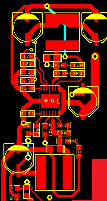

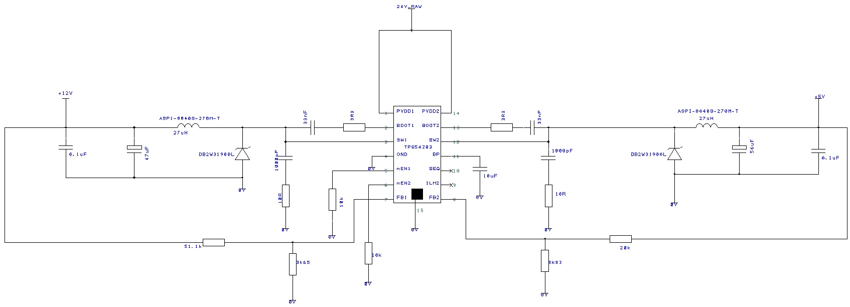

I have copied the suggested design in the datasheet of TPS54286 for 24v-to-5v&12V@2A as I have attached. I have attached the PCB too.
The problem is the output is 24V on Side 2. Side one is zero. This behavior has been repeated similarly 5 times, like one of them gets to 24v , and burns the switch and causes a short circuit afterwards. If I replace it, happens again.
1- I think I don't have short circuits anywhere or soldering problem, . I have a reasonable 330-ohm in the output of both sides.  I have attached the GND pad beneath. both enable pins are connected or pulled down to GND by a 10k resistor. at all times. Switch output also is always 24V on side 2 and 0V on side 1. FB on side one is 1.5V
Sometimes the chip immediately burns last time that I tried to be super careful, it didn't burn but gets hot. I have no other component in the circuit
The only difference is the inductor I chose and the diode.
