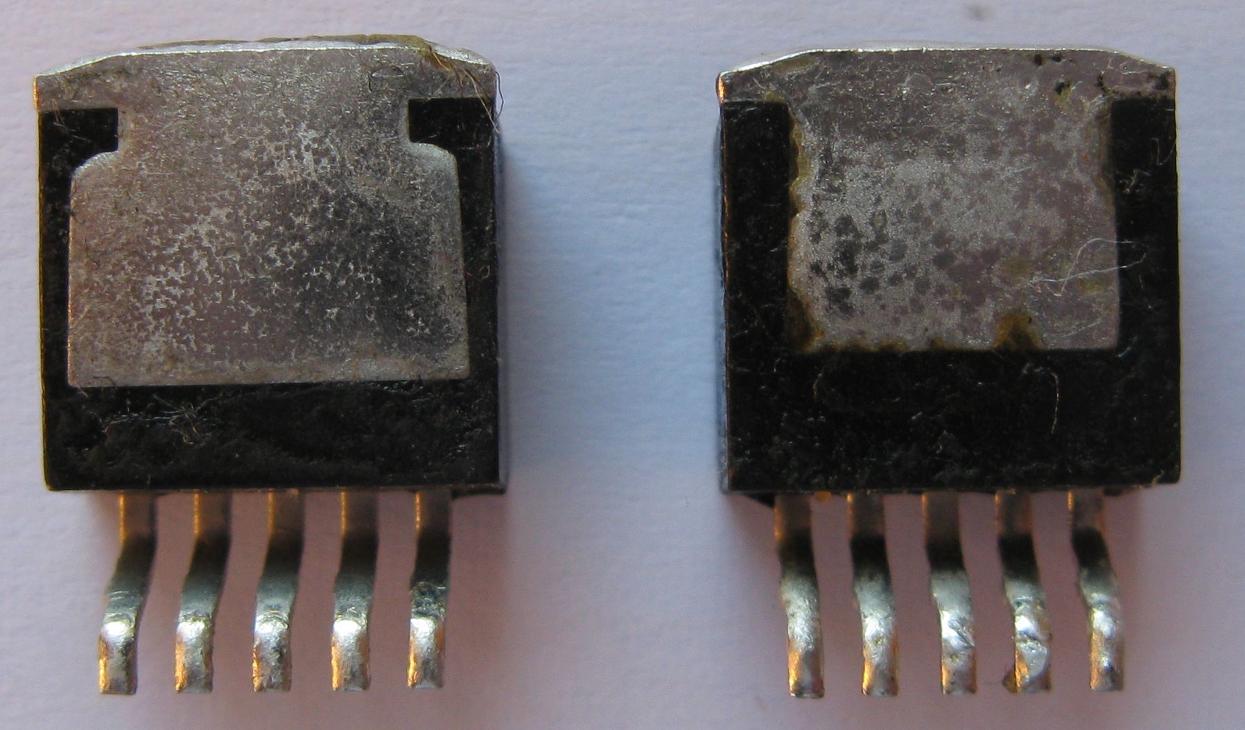

I use several kind of TI's linear regulators from long time and had never issues with them. Recently I've bought ICs from a new source and around 5% of them just don't work. I suspect ICs may be counterfeits, because they look slighty different than those i had been buying before (font size, shape of metal substrate).

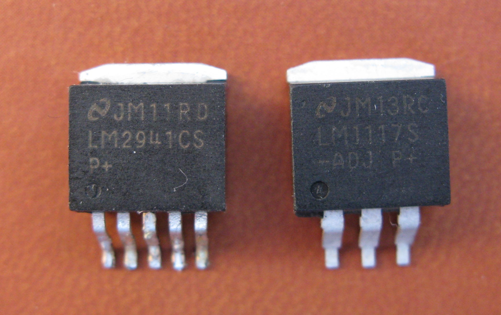

LM1941CS - they are marked JM11RD LM1941CS P+
I don't possess reel anymore, but wrote down LOT: EMAC2520C019, D/C 1106
LM1117SX-ADJ - these are functioning correctly, but also look suspiciously, marked JM13RC LM1117S-ADJ P+
I have 1500pcs in stock, reel and carton package seem to be original, LOT: EMAC7820C019, D/C 1118

  • Confirmation of devices as being ‘Authentic TI’, or not, is beyond my authority, but here’s my two cents anyway:
     The 'S' would refer to the National Semiconuctor marking for the TO-263 package.
    For the "LM1941CS", a search of TI.com for 'LM1941CS' returns:
        "No matches found for the selected search term (LM1941CS)"
    If this is supposed to be ‘LM2941CS’, then there is a problem.
     As for "LM1117S-ADJ" ... per TI.com, the device mark should be two (2) lines :
         Line 1 : LM1117S
         Line 2 : ADJ
    No dash (-), no ‘P+’.

    right, my mistake, correct part number is LM2941CS (LM2941CSX/NOPB more precisely).
    For LM2941CS marking seems to be OK, for LM1117S-ADJ not.
    But, is it even possible?:
    Both LM2941S come from the same reel, but they differ.
    Is there any place in Europe I could send some units for inspection ?
