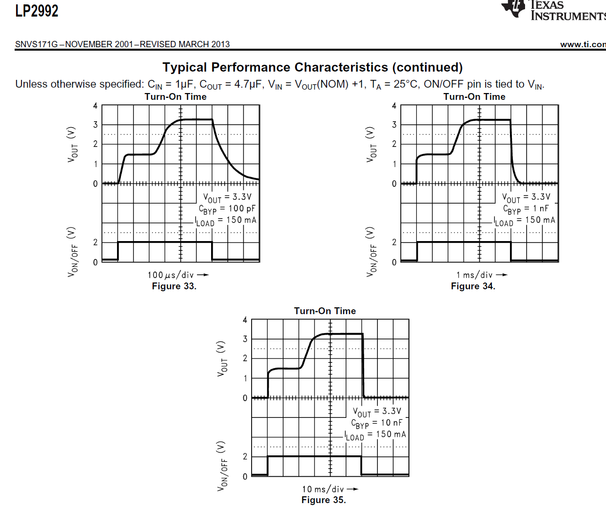

What is the internally defined soft-start time for TI LDOs, for which soft-start is not available as a controllable feature?
I am interested to know the internally defined soft-start time for LP2992 and TLV702xx family LDOs.
Do TLV702xx LDOs have monotonic rise to their steady state levels after being enabled via EN input?
Hi Sergei,
Any LDOs with a Soft-Start pin like TPS7A8300 or TPS74701 have a monotonic rise. Else, you'll have to look at the specific start-up graphs of the device in question as a monotonic start may not always be a prominent feature of lower current LDOs. As always, if you have a question about a particular device, feel free to shoot it our way.
Let me know if I can further assist,
Aaron
