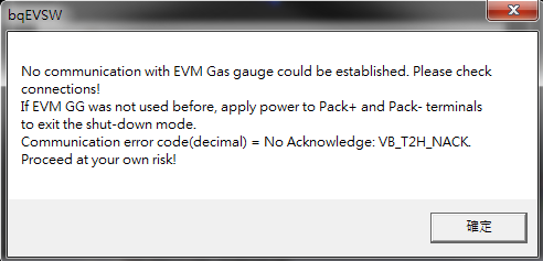

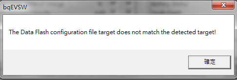

At first,  Bq20z75 was sealed. I try to unseal it by using the different version .DFI file.
After programming  Dataflash Image(.DFI file), BqEasy can't recognize the Bq20z75 chip.
What can i do to recovery the communication and unseal it?
Error message shows as follows figure:
Thanks a lot.
  • Hi Jason,
    You are supposed to use the unseal keys to unseal and not the DFI file. Also If you are in sealed mode I don't think you will be able to program a DFI file without first unsealing the device.
    If the device is in ROM mode and you can't exit ROM mode by sending command 08, I suggest replacing the IC.
    thanks
