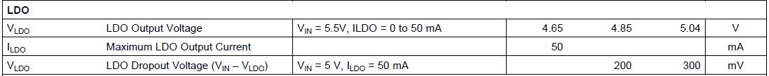

I'm designing a charging circuit using the bq24257 switching charger.
The bq24257 has a built-in LDO which is supposed to put out 4.9V. The bq24257 however is specified to run from 4.35V to 6.5V.
I'm planning to use the bq24257 at 4.7V supply voltage. What is going to happen to the LDO in this case?
I suppose it won't be able to put out 4.9V but rather 4.4..4.5V.

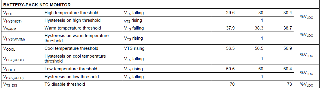

Will that have an impact on any of the functions of the bq24257, such as temperature sensing or the charging circuit itself?
Thanks for any help!

    The LDO internal to the BQ24257 will operate much like any other LDO when the input voltage is less than the designed regulation voltage by outputting the input voltage less the drop out voltage .
    The temperature sensing will scale with the output voltage of the LDO since the thresholds are determined by internal resistive dividers.

    All of this to say that device should work with a lower voltage since it has a recommended operating range down to 4.35V as long as the battery regulation is sufficiently below the input voltage.
