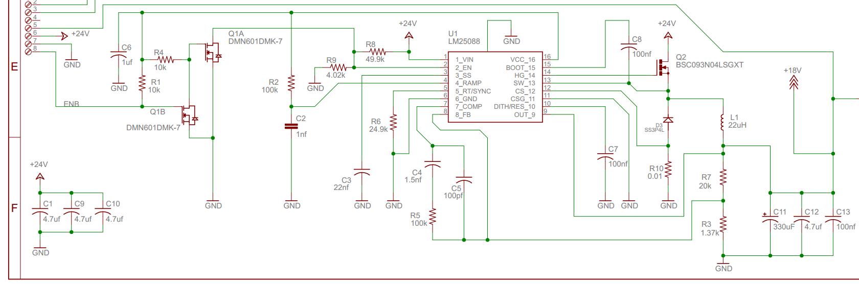

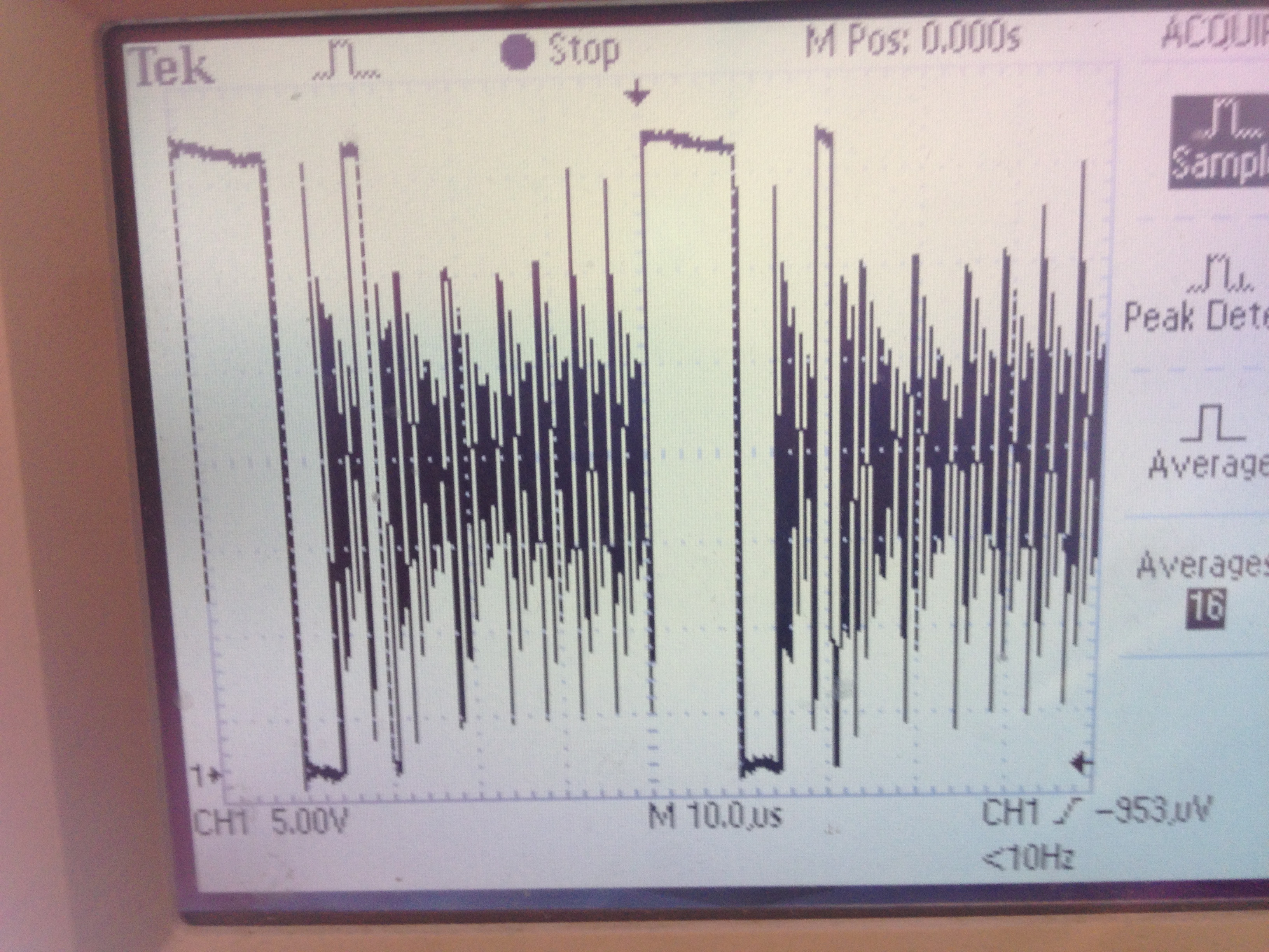

I am using an LM25088 voltage converter with an input voltage of 28V (regulated) and an Load voltage of 18.75 V. I am using a current sense resistor of 0.01ohms and expected an available load current of up to 10 amps. The system works well at Load currents under 0.7 amps, but at Load currents over 0.7 amps the Load voltage drops. When the load current reaches 1 amp the Load voltage has dropped to 9.0 volts.
I would appreciate any help resolving this issue
