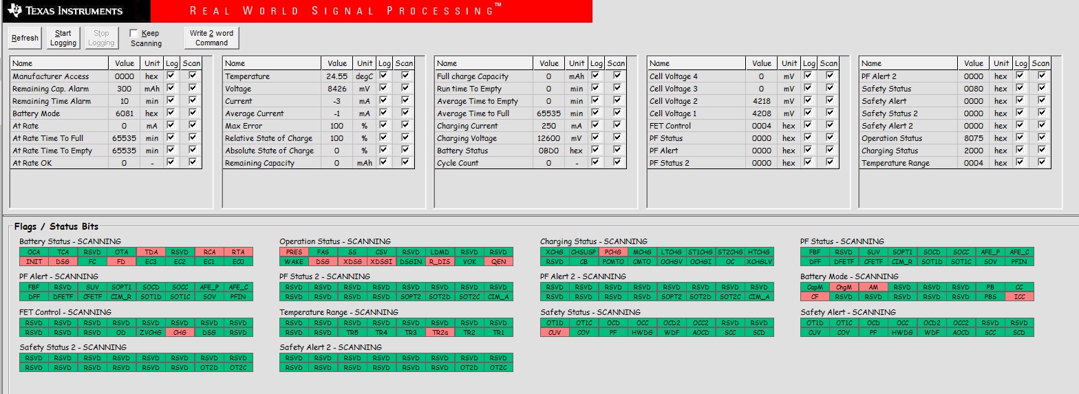

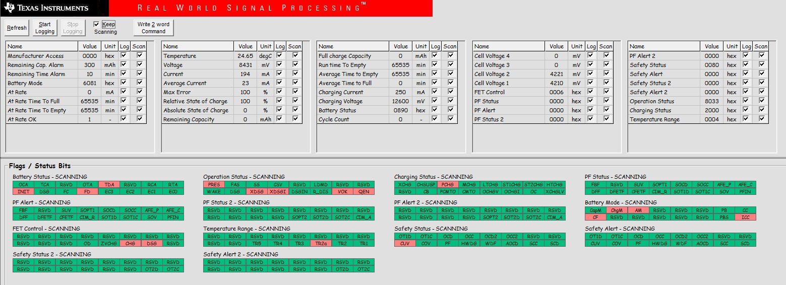

The problem is when I disconnect the charger. The DSC FET is turned OFF, and 2 errors flags are set:
XDSG and XDSGI
To be accurate, with no load, I can read 16V for 1sec, 5.4V for 1 sec, and then 0V. With a load, I read just few mV.
Any idea to help us for this projet ?
Thanks in advance.
Eric
  • Hello Eric,
    From your screen shots, I see the CUV bit is set in the safety status indicating that one of your cells is below the threshold set. Did you configure your device for 2 cells by setting the appropriate bits in the operation cfg A register in the data flash? CC1 should be clear and CC0 should be set.

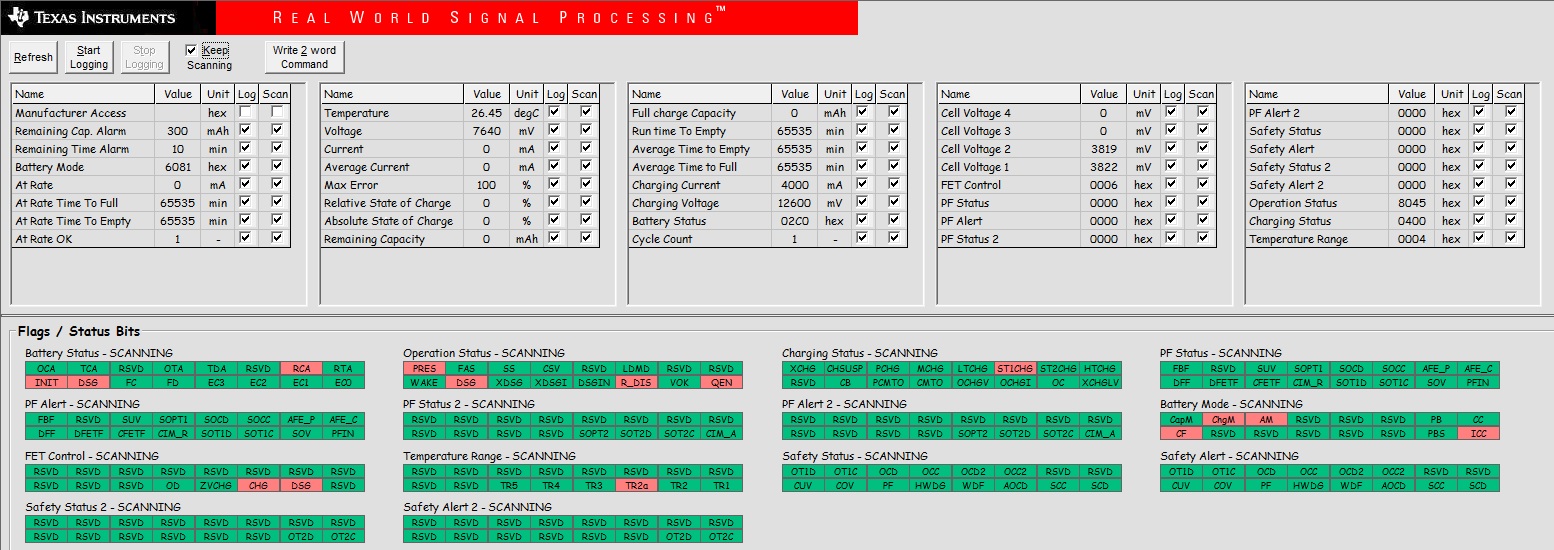

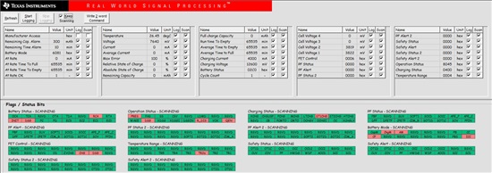

    I reloaded the flash with the from from my configured EVM module, and I no longer have these error flags.
    The actual problem now, on all prototypes, I don"t have a good voltage on the DSG pin. I read only 5.4V, and 6.2V if the R22 between DSG pin 1 and the gate of Q4 is disconnected, which is not enough for the discharge FET.
    I have the correct voltage on the charge FET (16V).
    Is there some SW issue, or maybe RoHS soldering temperature problem?
    Eric
  • Hi Eric,
    Clearly this will not be a SW issue. What does the voltage on the EVM measure? The simplest and first debug process will be to compare your circuit to that of the EVM. If they necessary sections are exact, try replacing/reflowing the solder on one of the ICs and see if that helps
