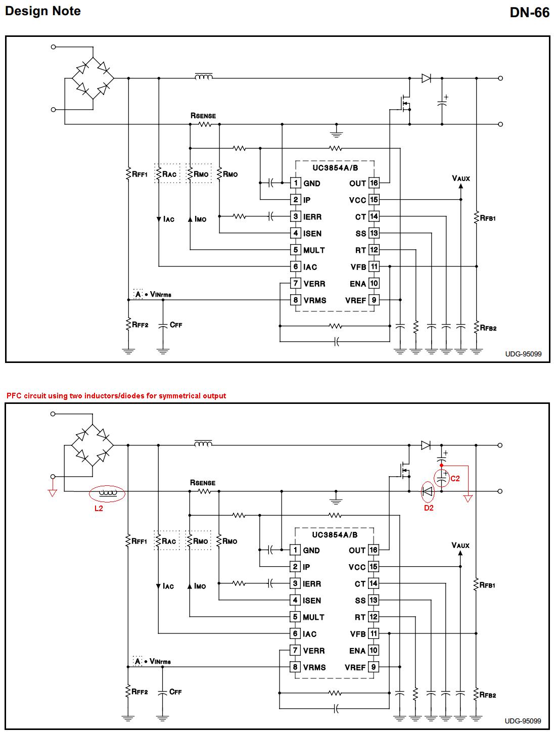

I'm using a UC3854 in a symmetrical output PFC circuit...
My question is:
All equations, values, etc are the same as used in a single output circuit?
Attached there is my circuit in comparision with Texas single output circuit.
