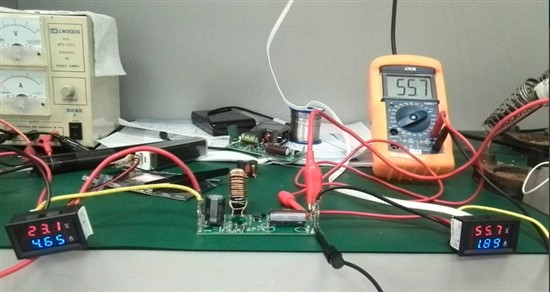

Hi ,
     I use LM5122 design DC-DC for battery charger device,24Vto 60V@2A,  the device output for R Load can work 60V @1.8A, but connect to 48V battery, battery voloatge is 51V, the device can't work, out put just 0Ato 0.18A wave,output voloatge is battery voloatge 51V. for some minute,the LM5122 chip broken. out feeback Rfbt use 110K,Rfbb use 2.2K. also CSN,SCP use 100&100pf.
     SCH use WEBENCH .
  • Hi
    The cycle-by-cycle current limit of LM5122 is triggered if the output voltage is lower than the target output voltage for a long time.
    This cycle-by-cycle current limiting activates LM5122's internal hiccup mode operation eventually. To disable the hiccup operation, please tie RES pin to ground.
  • Dear Eric Lee,
            Thnks for reply me, I do it by your suggestion, the devis out put is OK.  the DC-DC efficency about 98%.
    thanks again & HAPPY X’MAS!
