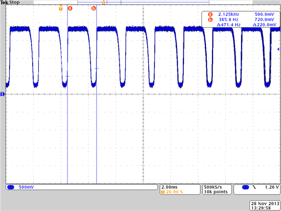

  • Hello Donald san,
    Thank you for the reply.
    Please see the attached picture.
    This is output voltage waveform when 2.4A cc mode by electronic load.
    I understand that this ON/OFF operation is result of thermal shut down.
    If the Electronic Load increases constant current to 3A, what happens ?
    Iout will be restricted Isc and then Vout will be decreased ?
    Ryuji Asaka
  • "... If the Electronic Load increases constant current to 3A, what happens ?..."
    Depends on how the electronic load behaves when it is programmed to sink more current than is available.
    ' ... Iout will be restricted Isc and then Vout will be decreased ?..."
    Yes. The output current reaches the limit and by definition (E = I x R) the output voltage must fall as the load demand increases (i.e. the Rload value decreases).
