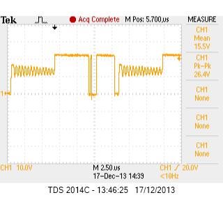

I have a bq24600 working and charging on my own board. All voltages seems OK and the current draw is good (1.2A). However the HIDRV looks like this:
BTST goes to 6V when LODRV is on so the bootstrap cap and schottky diode are working.
I have the EVM which works fine with the same configuration: i.e. square wave.
What would cause the HIDRV to do this?

    It is probably going discontinuous.  Try raising the input voltage or increasing the charge current.
    What is your input voltage and battery voltage and charge current?

    I have just decreased the input voltage from 16V to 14.28V and it has started working perfectly.
    So reducing the input voltage solves the issue, but I do need to run from higher input voltages.
    Does this mean it is related to the duty cycle? Will increasing the charge current help in this case?

  • I can confirm that the BQ24600 is going into discontinuous mode above an input of 14.6V. This mode then causes the current consumption to rise: this is not the current to the battery, just from the supply. The only difference between my application circuit and the EVM are board layout and FET's.
    I am wondering how much difference the output capacitance of the MOSFETs makes to the switching circuit. I am using FET's (Infineon BSZ097N04) with 340pF output capacitance compared to 185pF of the SiR426DP as used on the EVM. Otherwise the BSZ097N04 outperforms the SiR426DP.

    Just to conclude this post: I have prototyped this circuit on a redesigned PCB and it all now works very well. The main difference is which switching FETs were used. My new design uses the same FETs as the EVM: SiR426DP. My original solution used more modern devices with better performance: BSZ105N04 but I suspect this was the reason something was off. I am going to investigate out of curiosity.
