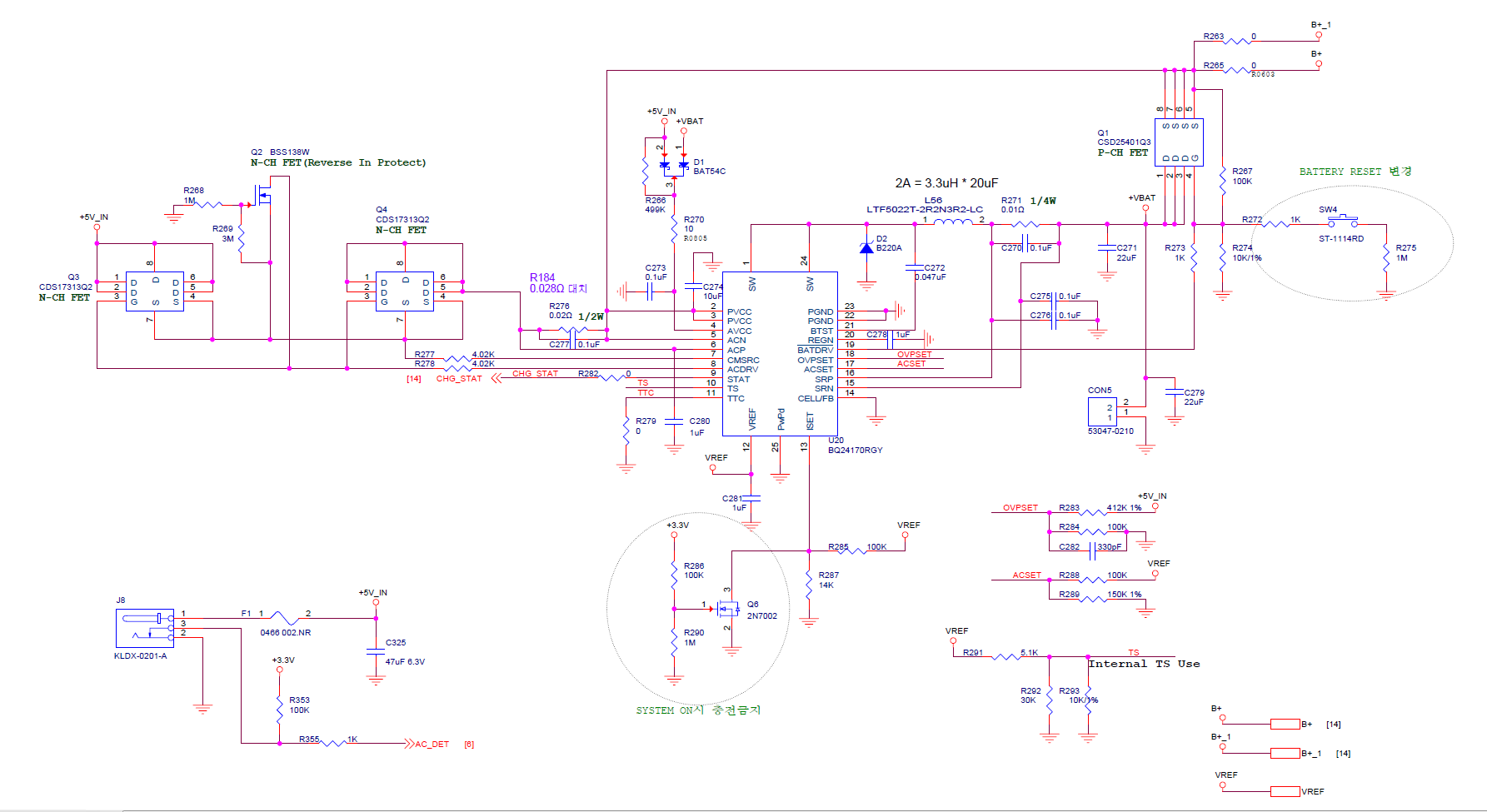

STAT pin of BQ24170 does not go "HIGH" even battery charging completed
Other Parts Discussed in Thread: BQ24170
Hi Engineers
I'm using BQ24170 for my mobile device.
Below is my situation
    - Input : AC Adapter 5V
    - Battery : Lithume-ion battery(3.7V)
Battery charging is ok but after completion "STAT" pin does not go "High"
Please refer to my schematic diagram.
Thanks in advance
