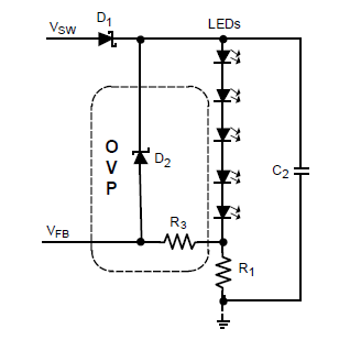

I have a LED Driving (Boost) circuit involving LM3410 for driving high intensity LEDs with a forward voltage of 6.4V and a forward current of 500mA.
I would like to the know the impact, if the load (the LEDs) gets disconnected from the driving circuit (say, due to user negligence), which could cause the feedback to the driver IC to be pulled low (since I have a limiting resistance connected to ground and in series with the LEDs).

    As I found in the data sheet of LM3410, when an LED fails open, or is connected backwards, an output open circuit condition will occur.
    - The Feedback voltage is pulled low.
    The LM3410 will react by increasing the duty-cycle, thinking the LED current has dropped.
    According to the equation in the data sheet, Vout/Vin=1/(1-D), the output voltage will increase.
    As you can see in the above figure, “if the output voltage exceeds the breakdown voltage of the zener diode, current is drawn through the zener diode, R3 and sense resistor R1. Once the voltage across R1 and R3 equals the feedback voltage of 190 mV, the LM3410 will limit its duty-cycle. No damage will occur to the LM3410, the LED’s, or the zener diode.”

  • Hello Santhosh,
    The typical value of feedback voltage is 190mV and there is a ±12mV margin for process variation. What you should do is to select a suitable R1 to make sure the R1*Iout is in the range of 178mV and 202mV. For your case, a 0.3Ohm sensing resistor should be fine.
    What if the feedback voltage is pulled down to ground? The IC will increase the duty cycle which will increase the output voltage because the IC thinks the output current has dropped (VFB = R1* Iout).
    Since LM3410 is a constant current converter, the output current won’t have significant change in normal condition expect for output short circuit and open circuit. You can’t protect the inductor and diode when output short circuit happens as the Vin is connected to the output load directly. But output over voltage protection can be achieved. As I mentioned early, the OVP circuit consists a zener diode D2 (for your case, an 8V zener diode should be fine) and R3 (100Ohm is OK, too small is not recommended).
    For the last question, the duty cycle will decrease if VFB increases and vice versa. But there is a limit of the duty cycle. You can refer to the data sheet for the values.
    Please let know if there is anything that I haven’t make it clear.
    Victor

    I am looking at a design with similar output OVP requirements.  So, in the example above with 8V zener and 100 ohm series resistor what would be the current that needs follows thru the zener diode for regulator to stop increasing the output voltage.
    I thought 500mA is needed so that the FB pin gets to 190mV but total current is limited by 100 ohm series resistor?
