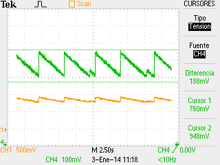

I have followed the design from WEbench step by step but it doesn't work when i ask it more than 0.8A, Any idea about what is my fault? Thanks in advance

What input voltage and output voltage was this designed for? Also, did you put the circuit on an EVM or a custom pcb?
If you can get a screen capture of what the output voltage and PH pin is doing above 0.8A this can also help to debug.

First of all, thanks for the answer. Well, the yellow signal is the output, as you can see, it is oscillating at 850mV . The green one is the PH signal. I get similar result with 12V, 14V and 16V output, i mean, i test the circuit with 28V in the input. I change the necessary components to 12V at 850kHz, to 14V at 800kHz and to 16V at 800kHz, i change the value of the resistor and capacitors as Webench tells me, and i get similar result. If i don't put load, i get the 12V, 14V and 16V. If i put a load, in the moment which i overcome 0.8A...........it gets down. In theory, the circuit has to give me 12,14 or 16V at 2A. Above all i want to remember you that i changed the resistors, capacitors, diode and bobine,ok? I mean i follow the advise of Webench. So.... i am not sure if there is any limitation that webench doesn't know.
At the other question, i use a custom pcb which follows the same print that EVM.
