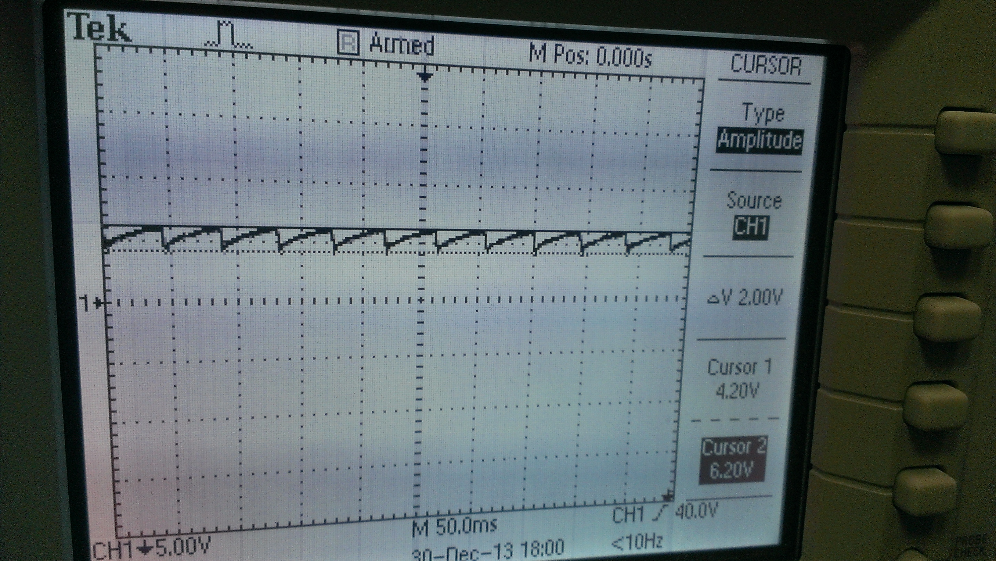

  • When you say "go inside oscillation" what do you mean exactly?  Can you post waveforms that show your concern?  Did you modify the EVM at all?

    when I say oscilation I mean the voltage is constantly changing down an up, I attached a scope image where you can see the voltage dancing around between 6.2V and 4.2V.
    the input supply is simply a power supply on 7V and limited to anything less than 280mA causes this phenomena.

  • I think it's worth reading those 2 ANs as they directly apply to what you will be doing.  Your Vin waveform matches what is achieved with those circuits, which is delivering the most power possible to your load with a power limited input source.
