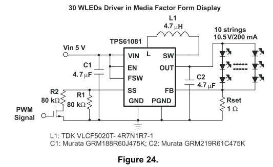

TPS61081 PWM dimming - timing limits?
Other Parts Discussed in Thread: TPS61081
We are using the TPS61081 to drive the backlight of a TFT display using the circuit shown on page 24 of the datasheet.  We have noticed that the TPS61081 does not behave as expected with higher frequency PWM, and extremes of duty cycle (eg. 2% or 98%).
What are the limits on the timing of the PWM waveform?
What are the mimum on and off times for the FET?
