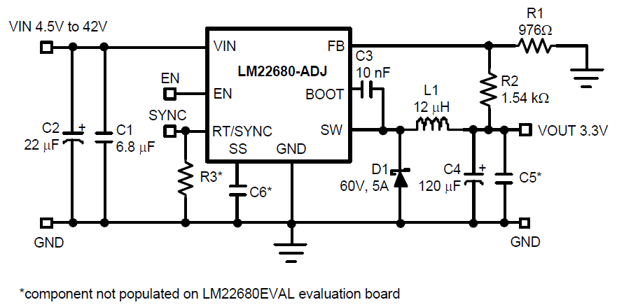

Our customer will use LM22680 device. If see datasheet, it did use Aluminum capacitor(C2/C4) in Input/Output.
If see LM22680EVM, C2 is 22uF(EEEFK1J220XP,Panasonic) and C4 is 120uF(APXE6R3ARA121ME61G, Nippon Chemi-Con) .
To calculate life time of aluminum capacitor, Out customer need ripple current of C2(Input)/C4(Output) in EVM.
Out customer condition : Vin=30V, Vout=3.3V, I=1A
