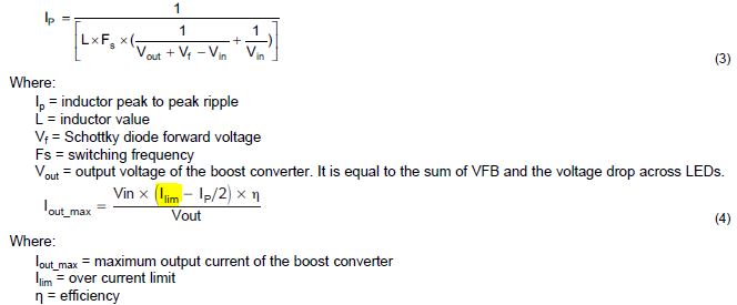

I am going to use the expression listed in a data sheet  page10 (3),(4).
Which value should 「Ilim」 of expression (3) use?
Should I use Ilim(min) listed in data sheet P3?
(However, it is listed in a data sheet with a result of Vin=3.6V.)
Can it be used on condition of other than Vin=3.6V?
