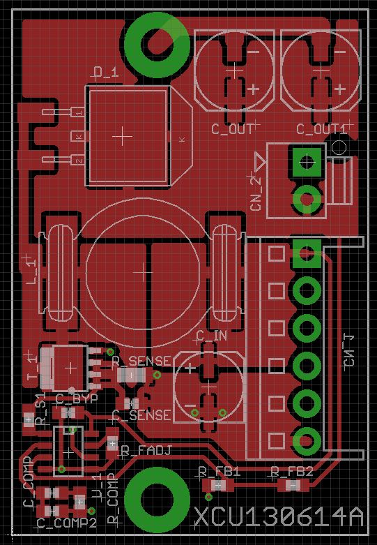

Hi all,
I designed a boost converter based on LM3478 using webench.
Main characteristics are:
Vin=12V
Vout=19V
Iout max=2.5A

I slightly adjust webench component values to obtain the following schematic:
My problem is after receiving prototype, I measure huge switching noise.

I know Csense should be directly connected to Isense pin. So I tried shorting RS1 but nothing changed.
Current limit doesn’t work (at 3A output converter still provide 19V).
Does the problem come from BOM or PCB layout?
Many thanks in advance.
    Question 1.  Noise.  This type of high frequency noise is usually due to layout.  On a boost converter the important loop is between the the FET drain -> diode -> output cap -> and the FET source.  Try to make this loop as tight as possible.  Look at adding some x5r or x7r 0.1 to 1uF ceramic capacitors to the output as close to the source of the fet and the diode as possible.
    Question 2.  There can be variation in the current limit due to mosfet on resistance and other factors.  If the on resistance of the FET is lower than expeced this would lead to a high current limit.  Try adjusting the limit down.
    Marc

    If necessary have a look at PCB layout:
    I assume critical path is right, isn’t it?
    How to improve noise immunity?

  • Critical loop is high light above.  You want to place the ceramics as close to the bottom of the sense resistor as possible to filter high frequency noise.
