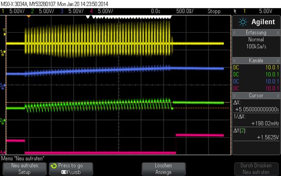

I’m using the BQ25504 as an energy Harvesting Module with a solar cells. For this I’m using the circuit like Figure 2 in the Datasheet. The thresholds are:
UV = 2,4V
OV = 3,5V
Vbat_pog = 2,7V
Vbat_hys = 3,3V
In the first step everything is ok. The circuit has no load and the Boost Converter Charge the battery Capacitor up to 3.5V and Vbat_OK Pin get high. If the Circuit gets a load on Vstor the boost converter charge the battery capacitor and the Vstor capacitor up to 5V. Then it is switch off till 3.5V in Vstor is reached an it charge it up to 5V.

  • Can you take a scope shot of VSTOR and the switching side of the inductor, showing VSTOR rising from 3.5V to 5V?  I want to confirm that the IC is actually switching when the load is attached.
  • Hello Jeff,
    enclose a scope print, showing VSTOR rising from 3.5V to 5V.
    yellow line = switching side of the inductor
    blue line = Vbat
    green line = Vstore
    red line = VBat_OK pin

  • The reduced resistors are good.  Solder flux residue is not the issue.  Keep in mind that the VBAT_OV is only sampled every 64ms.  Is the load you are applying on VSTOR a pulsed load that is faster than 64ms?  If so, then it could be that the load transient is hitting just before the last VSTOR sample, causing VSTOR to droop, but then the load transient ends before the next sample.  If that is the case, then I suggest increasing the VSTOR capacitor to better handle the load transient.
  • The load i have connectet is an linear none pulsed load.
    But with the less resistor ist dosent matter if an load is attached or not . The Vstore and Vbat rise up to 8V which kills the bq25504.
    With the old loads >1Mohm on startup and no load is connected the bq25504 keeps the conditions. Only if a load is attached the Vstore rise up to 5V  and the bq25504 dosent respect the adjusted thresholds.
  • Is this on an EVM or on your board? If on your board, are you certain that the VBAT_OV resistor network is properly connected to the RDIV and OV pins?   Is the load a simple resistor?  Is it possible that the load itself is raising the voltage with current backflow?
